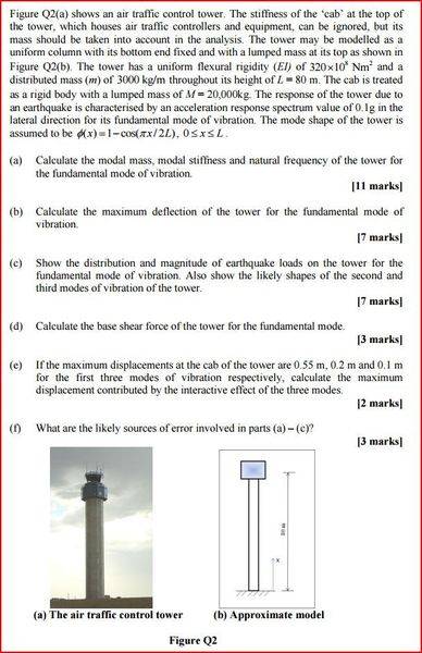

The question is featured in the image below. I know the methods to calculate modal mass, stiffness etc, I'm just not too sure how to model both the distributed and lumped masses together.
Modal Mass, M* = ∫m.φ^2(x) dx
Say for instance, that the tower had no lumped mass at the top, so we only had to consider the distributed load (m = 3000 kg/m), the solution would be:
M* = m∫φ^2(x) dx (limits of integration are from 0 to L(=80m))
∫φ^2(x) dx = ∫(1-cos((πx)/(2L))^2 dx = L - 4L/π + L/2
M* = 3000 x (80 - 320/π +40) = 54423kg
My issue is not knowing how to combine the distributed and lumped masses together for this calculation. Any help is greatly appreciated
I've managed to solve the problem now. Thank you for the concern though!
