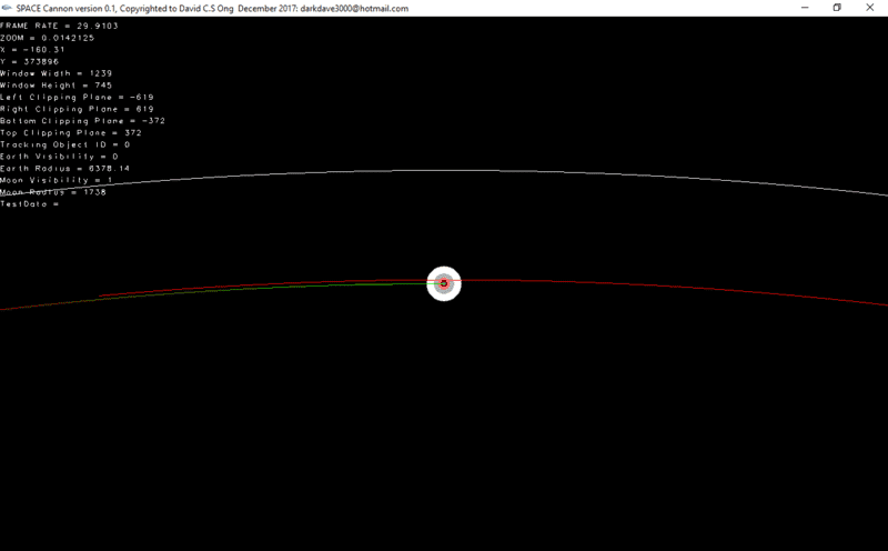

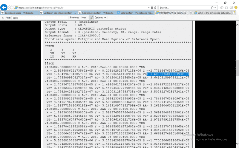

The Earth-Moon distance varies so neither orbit can be circular. There is very accurate information about the Earth-Moon distance so that gives Earths radius of orbit from simple lever calculations. The only bit of hard work is searching for the two bits of data to the accuracy that the OP wants.
nssdc.gsfc.nasa.gov/planetary/factsheet/moonfact.html

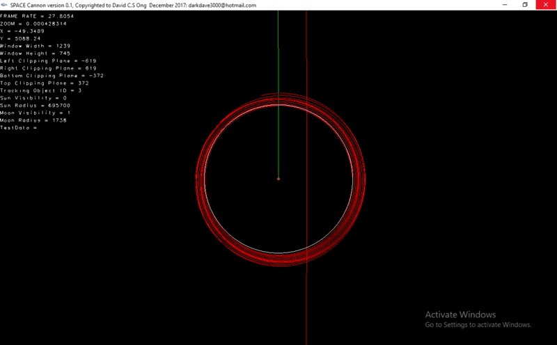

From the above link I fed in some data into my simulation software using Runge Kutta and Improved Euler methods, both yielded a result where Earth and Moon slowly moved away from each other.
I had Moon at position X = 0km, Y = (405400-4671)km, Velocity: X = -0.970km/s
Earth X = 0km, Y = -4671km, Speed: X = 0.01193km/s
barycentre: X = 0, Y = 0
Ignore the straight lines coming from Earth, their paths of a projectile simulation gone wrong. The large white circle centred on the Earth and stretches near the moon is just the average distance from Earth to the Moon so it's just a marker. The curvy lines are what you need to pay attention to as they trace out the orbits of Earth and Moon and turn from Green to Red gradually over the passage of time. The small white circle in the Earth is the barycentre.
I don't understand the mechanism that this is simulating. Unless you include tidal locking, why should the separation be increasing?
I can't see why the ratio of the speeds of the two bodies is not just inversely proportional to the ratio of their separation rom the BC. This has been spelled out by @jbriggs444 already. Is there some extra agenda here that you haven't mentioned?
Agenda? I just want to achieve stable orbit. The mechanism is Newtonian physics, at each time increment(about 1/30th per second) the computer calculates the acceleration due to gravity of both objects to each other and adjusts the velocity and displacement accordingly. It's using Acceleration = Gm/r^2 and velocity = v+at and displacement = 1/2 at^2 + vt.
Basically Newtonian physics. The initial figures I used already spelled out above in km. And I get these results as seen in the screenshots. I tried adjusting the distance and speeds but they caused even more instability.

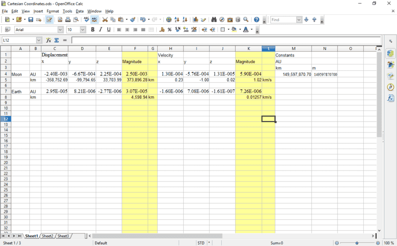

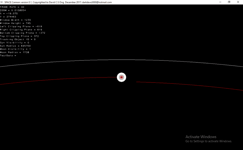

I managed to improve results by decreasing the size of the time step down to a minute per increment. I guess once I get it down to a second the decay will disappear.
What do you think? Will General Relativity eliminate the decay completely?
The orbital decay is a numerical problem resulting from your implementation of the model, not a problem with the model per se. There is no orbital decay (or acceleration) in the Newtonian model. Changing it out in favor of general relativity will not help.

Anomaly from real life data I am talking about is:
The orbital speed at the moon's distance from Earth should be 1.03km/s but the moon is moving at 1.02km/s. Could this anomaly be what's causing the decay because my simulator doesn't use GR field equations to make the rotation rotate instead of decay?

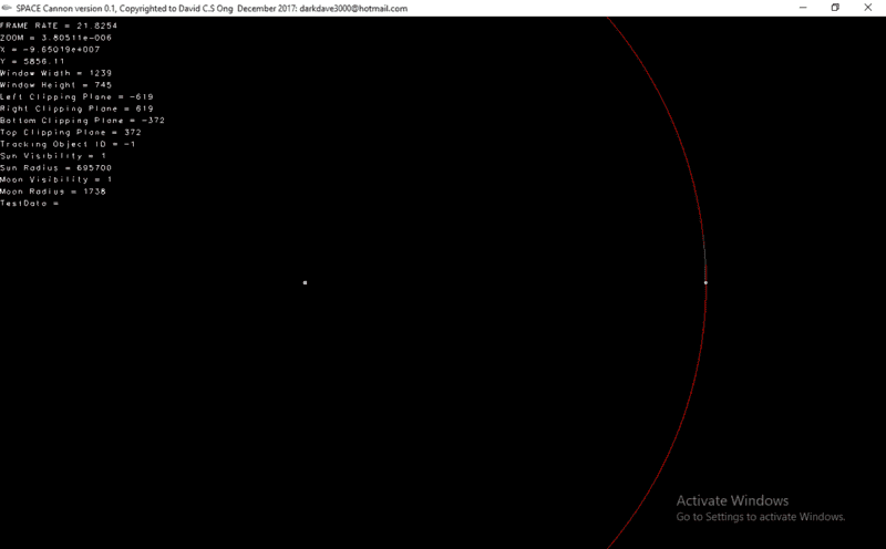

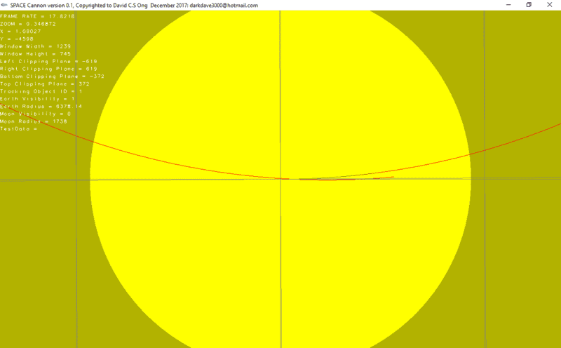

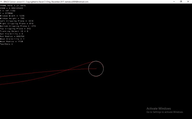

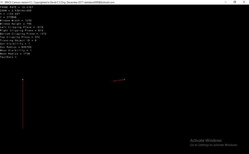

Ok I have added the sun into the simulation. What this did was make the moon actually go the opposite direction but only slightly. So the moon is now falling toward the Earth(slightly). However when increasing the jump from 1 minute to 13.6 minutes the moon now looks like is falling away again however this is the jump I need to create a full Earth orbit which seems to be falling away from the Sun.
Have a look at the following screenshots.
How strange... why would the moon now be falling toward the Earth with all correct data including the Sun? Do I need to add in the gas giants too?

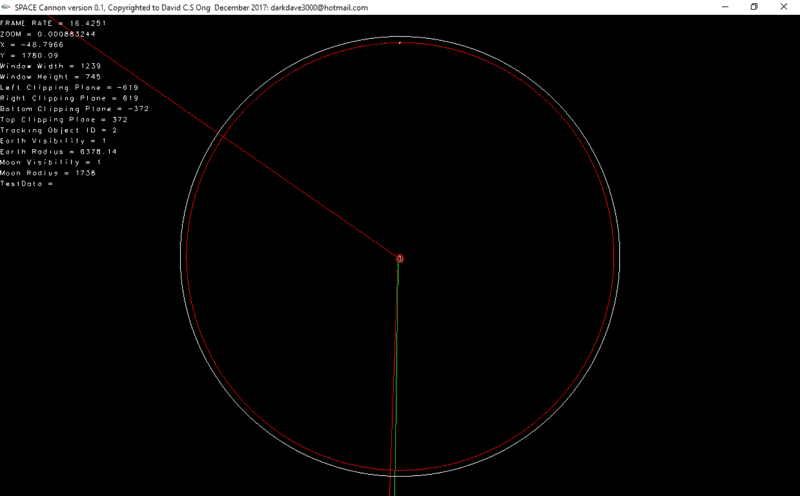

Update: Ok the moon's orbit around the Earth is adjusted so it's always relative to the Earth's core, not the barycentre, so it's not so accurate. I'll run the sim again with the sun moving opposite to the Earth's velocity instead of being stationary while making Earth and Moon not move at Earth's speed. That way Ill be able to redraw the moon's orbit but relative to barycentre.
Oh man, … with the sun in there I cannot keep track of the barycentre...

That's not what you wanted to do. Adding the Sun just compounded the problem by adding extra factors when your original simulation wasn't even accurately modeling the simple scenario.
Earlier you said that you used 1/2 at^2 + vt. to calculate the displacement. But that will not give you the proper displacement for an orbiting object easily.
In the top image we show an object moving to the left at v with a downward acceleration of a downward. A simple application of the above equation will give you the displacement and new motion after some time t as shown in the second diagram. with the object following a parabolic path.
However, if the object is in an circular orbit ( where v is the circular orbital velocity) then it new position will be like the blue object in the bottom diagram and its path will be an arc of a circle. This is because, unlike the second diagram, which assumes that gravity acts in one direction the whole time, gravity really acts towards the center of the orbit which means by the end of the time period, it is pointing in the direction of the red arrow in the third diagram. With the Second diagram, the acceleration never effects v, and the final velocity is the vector sum of the velocity due to that acceleration and the original value of v and will end up being greater than v. In the third diagram, the direction of aceleration changes with respect to the original direction of v, and as a result the leftward component of the object's velocity will be less than the original v and it will end up that the new speed of the object, though in a different direction, will be of the same magnitude as the original v.
This error compounds with each time period even if at the end of each time period you reorient the direction of a to point towards the center of the planet.
Now, the smaller the time period you use, the smaller the difference between the two predicted paths. If you divide the above time period by ten, you get an much smaller deviation between the green and blue paths. So much smaller, that even after ten of these smaller time divisions, the total difference will still be smaller than when you used the one larger time period. This is why your simulation performed better when you used smaller time steps.
Orbital mechanics is just not a easy thing to figure out from the basics on up. Even Newton basically had to invent calculus in order to tackle it.
