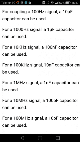

Screenshot of a text list giving coupling capacitor values by signal frequency: 100Hz with 10µF, 1000Hz with 1µF, 10KHz with 100nF, 100KHz with 10nF, 1MHz with 1nF, 10MHz with 100pF, 100MHz with 10pF.
I found this in a site called "Learningaboutelectronics" and it says I can use this table to choose a coupling cap for my frequency needs. This sure solves some of my problems, but I need to know how they got these values.

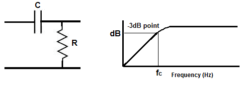

If you replace the transistor and all it's biasing components with a resistor equal to the input impedance then you essentially end up with a high pass circuit like this..
Left: a series capacitor C feeding a shunt resistor R to ground, forming a high-pass RC circuit. Right: a Bode-style plot of dB against Frequency (Hz) with a -3dB point marked at fc, rising then flattening.
Choose C to set the corner frequency.

Yes, there is. The corner frequency is equal to Fc = 1/(2*Π*R*C)≈ 0.16/(R*C). The frequency at which R = Xc
C is the capacitance of a capacitor and the R is the resistance "seen" by capacitor The effective resistance that will discharge the capacitor.
So for Cin we have Cin ≈ 0.16/(Rs + Rin*Fc), Ce ≈ 0.16/(1/gm * Fc), count ≈ 0.16/(Rc+RL*Fc)
Rs - is a signal source resistance
Rin - the amplifier input resistance ≈ R1||R2||(β*1/gm )
gm - the BJT transconductance gm ≈ Ic/26mV ≈ 40*Ic

Thanks! And the input resistance is given by R1||R2 + the transistor's input resistance(Ube/Ib)?
Yes.
