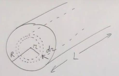

Now, to get the flow per time unit I’d have to multiply that formula ##v(r)## with the area of the tube ##π \cdot r^2##. But since the velocity differs with ##r## I’d have to integrate the whole formula over small ##dr##’s.
Here’s where I’m stuck, because if I choose to integrate the circle area ##π \cdot dr^2##, then the integration would just keep integrating a fixed circle area. That’s incorrect because substracting a circle area of ##π \cdot (n \cdot dr)^2## from a circle area of ##π \cdot ((n-1) \cdot dr)^2)## with ##n## being whole numbers, gives circle areas of ##πr^2##, ##3 \cdot πr^2##, ##5 \cdot πr^2##, etc. I don’t know how to put this in a formula before starting the integration.
Watching the previous video I gave a link to shows that I’d have to integrate ##2 \cdot π \cdot r \cdot dr## multiplied by ##v(r)##. But I don’t have the slightest idea how he came to ##2 \cdot π \cdot r \cdot dr## based on the following picture:
Hand-drawn diagram of a cylindrical pipe seen in perspective, with dashed concentric circles inside its cross-section. Labels R at the outer wall, r for a radius to an inner circle, dr for the thin gap between two circles, and L for the pipe length.
The area over which v(r) applies is the anulus of area ##\pi(r+\frac{dr}{2})^2-\pi (r-\frac{dr}{2})^2##, where r is the radial location at the mid-point of the anulus. But this is just equal to ##2\pi r dr##.
Also, from calculus, ##d(r^2)=2rdr##, so, in your own development, ##\pi d(r^2)=2\pi r dr##

Ah, this clears it up, thanks a lot! I got confused from the drawing because he's showing the length ##r## not extending into the mid-point of the annulus but being a separate length away from the width ##dr##. From that drawing I'd have therefore concluded that the area of the annulus should be ##π(r + dr)^2 - πr^2##. But why can't one describe ##r## like this and give this formula instead before integrating?
