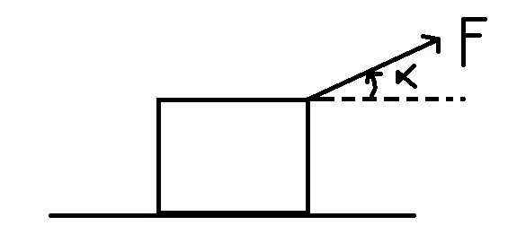

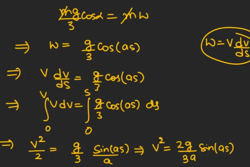

A bar of mass m resting on a smooth horizontal plane starts
moving due to the force F of constant magnitude. In the
process of its rectilinear motion the angle α between the direction of
this force and the horizontal varies as α = as, where a is a constant,
and s is the distance traversed by the bar from its initial position.

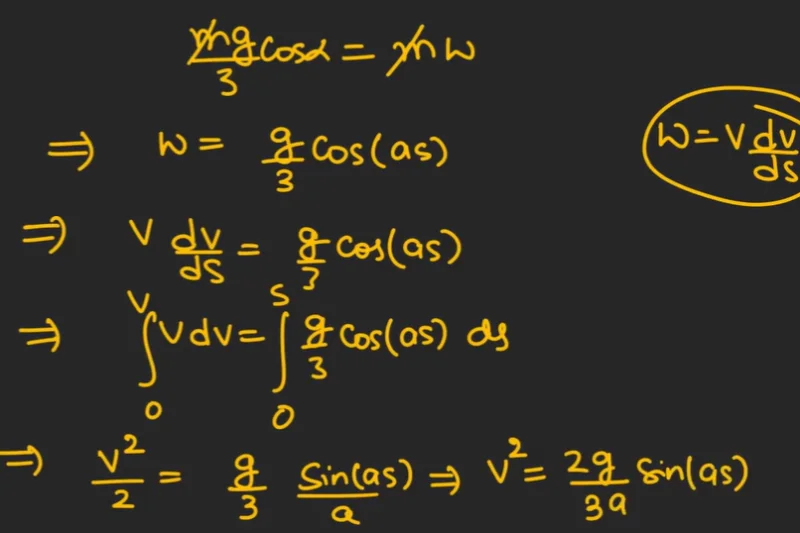

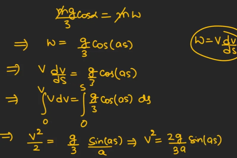

Find the velocity vector of the bar as a function of the angle α. I have tried solving it for all α in the interval [0, inf] but I was only able to find the velocity vector for the angle α in the interval [0,pi/2].

wrobel said:
picture is needed
Sure, a sec

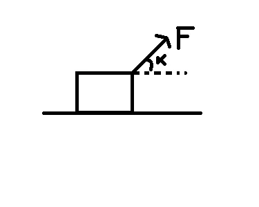

wrobel said:
picture is needed
the 2nd Newton is ##m\ddot s=F\cos(as)## and ##s(0)=0,\quad \dot s(0)=0##.
multiply both sides of the equation by ##\dot s##:
##m\ddot s\dot s=F\dot s\cos(as)## or equivalently
$$\frac{d}{dt}\Big(\frac{1}{2}m\dot s^2-\frac{F}{a}\sin(as)\Big)=0$$
finish it by yourself

my doubt was stupid. that time derivative when simplified gives:
1/2m.(ds/dt)^2 = (F/a).sin(as)
-----> ds/dt = +-[(2F/ma).sin(as)]^1/2
since ds/dt > 0 , ds/dt = [(2F/ma).sin(as)]^1/2

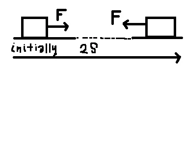

the body accelerates from as----->0 to pi/2 , attains maximum speed(say at distance S from the initial point) and retards at the same rate i.e., its velocity is equal to 0 at distance 2S from the initial point. At that distance 2S from the initial point it just repeats everything it has done in the opposite sense (motion towards the initial point). I finally get it now

This is a periodic back-and-forth motion, and ## s ## is the distance of the moving bar from its initial position. Why do you expect ## s=\alpha/a ## to be in the interval ## [0,\infty) ##?

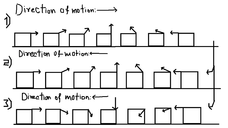

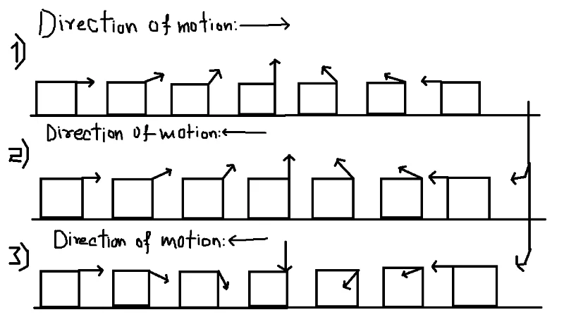

In the diagram, the arrows attached to each block represent the applied force vector at different positions along the motion.
In case (1), regardless of whether s is interpreted as the displacement from the initial point or as the distance traveled, the resulting motion is the same because the body has not reversed direction.
In case (2), s is naturally interpreted as the displacement from the initial position, whereas in case (3), s represents the total distance traveled along the path.
In either interpretation, however, the horizontal component of the force vector, which governs the rectilinear motion of the body on the smooth plane, remains the same at a given value of the angle. Therefore, the equation of motion along the horizontal direction is unaffected by whether s is taken as displacement or as distance, provided the direction of motion is treated consistently. (Apologies for the rough sketch)

griffith said:
what if s is the total distance traversed by the body?
The exact wording suggests that is the intention. This is reinforced by its asking for the velocity vector, not the speed. If we only take ##s## as the modulus of the displacement then the sign of ##v## is indeterminate.
To avoid confusion, I'll use ##S## for the displacement (which is never negative) and ##s## for the cumulative traversal.
In post #1 you found that ##(\dot S)^2=(2F/ma)\sin(aS)##.
You derived this from an equation of the form ##\ddot S=k\cos(aS)##.
But if we define ##s## as the cumulative distance then the initial equation for that is different. If we plot ##S## against ##s## we get a sawtooth: /\/\/\… ; ##\dot s## is nonnegative always, but ##\dot S## alternates between ##\dot s## and ##-\dot s##.
A solution for ##\dot S## (which the question appears to be asking for) can be written in terms of ##s## by using functions like modulo() and sign(). This is most easily done by starting with the solution for ##\dot S## as a function of ##S## and applying a little reasoning, rather than starting from scratch with the right differential equation.
