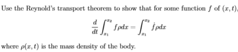

Typeset problem: use Reynolds transport theorem to show d/dt of the integral from x1 to x2 of f rho dx equals the integral from x1 to x2 of f-dot rho dx, where rho(x,t) is the mass density.
one dimensional Reynold's transport theorem
Equation of the one-dimensional Reynolds transport theorem: d/dt of the integral from a(t) to b(t) of f dx equals the integral from a(t) to b(t) of the partial derivative of f with respect to t dx, plus the derivative of b(t) times f(b(t), t), minus the derivative of a(t) times f(a(t), t).
Equation: d/dt of the integral from x1 to x2 of f rho dx, where the time derivative d/dt acts outside the integral with fixed limits x1 and x2.

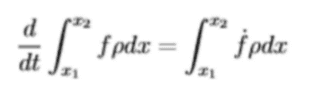

This is the farthest I have gotten so far. I got stuck from here. I do not know how to get from the shaded equation to the equation below.
Integral from x1 to x2 of f-dot times rho dx, written as a handwritten-style equation with a dot over f.

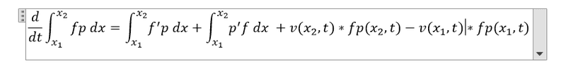

Substitute ##v_1=\frac{dx_1}{dt}## and ##v_2=\frac{dx_2}{dt}## into your second equation. What does that give you? Incidentally, the ##f\rho##'s in this equation should be evaluated at 1 and 2.

Equation: d/dt of the integral from x1 to x2 of f p dx equals the integral from x1 to x2 of f' p dx, plus the integral from x1 to x2 of p' f dx, plus v(x2, t) * fp(x2, t) minus v(x1, t) * fp(x1, t).
Sorry, there was some typo in my question. So, I ended up with the above equation using your advice, but it doesn't seem to get me any further. Both f and p are functions of (x,t), so it's hard for me to simplify easily. Is there any relation that can let me convert the above equation to the below equation?

Maybe it would help if I wrote your expression using LateX, which you should learn from the PF tutorial:
$$\int_{x_1}^{x_2}{\left(\rho\frac{\partial f}{\partial t}+f\frac{\partial \rho}{\partial t}\right)dx}+(\rho v f)_{x_2}-(\rho vf)_{x_1}$$
Does this give you any ideas?

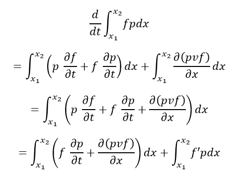

Handwritten-style derivation of d/dt of the integral from x1 to x2 of f p dx, expanded by the product rule and then rearranged into integrals involving p, f, partial derivatives of p and f with respect to t, and the partial derivative of pvf with respect to x.
This is what I have based on your advise.

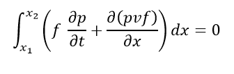

In order to derive the equation given by the question, the following equation needs to be true:
Handwritten-style equation: integral from x1 to x2 of (f dp/dt + d(pvf)/dx) dx = 0, with x1 and x2 as the integral limits.
If f is independent of x, I can easily extract f, and prove the above equation by using the mass balance equation. However, f is a function of x and t, so I am not so sure how I can derive the above equation...

The f' they are referring to is not ##=\partial f/\partial t##. It is $$f'=\frac{\partial f}{\partial t}+v\frac{\partial f}{\partial x}$$
Yes I got it now. It simplified quite easily with your help. Thank you.
