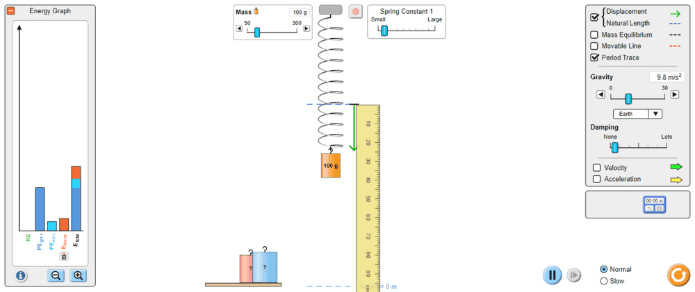

swueettea
determine the mass of the pink and blue objects by using Hooke's Law and by period.
T=2π( √m/k)
F=kx
time/#periods=T= 30.58/10= 3.058
Displacement=.6m
T=3.058
I tried to rearrange hooke's formula to k=f/x but f=mg and I don't have mass.
Using the period formula is also hard because T=2π( √m/k) and I have neither m or k :/
Please help thanks.

Do you have information about that yellow ##100g## mass?
omg wait I didn't think about the 100g thank you. The displacement is 25cm(.25m) and F is 1N so the K=4N/m right? And that's the K I would use for the other masses?

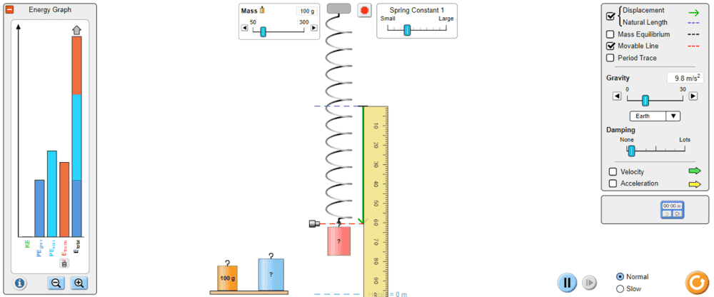

The given displacement and period are not compatible. Is the displacement for the larger mass and the period for the smaller mass?
The period and the displacement in the post problem is for the pink object but wouldn't the spring constant I found for the 100g object work for all of them? the information I used to find the spring constant I got from the 100g object (the .25m and 1N).

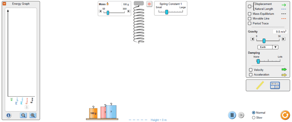

It's not clear from the diagram what information you have. If you have either the displacement or the period for a known mass, then you can get the spring constant.
is this clearer?
But how could I find the spring constant with just the displacement or period if k=f/x and f=mg?

Why can't you get the spring constant from the 100g mass?
Then it'd be 4N/m since 1N/.25m=4N/m right? And I can use that for the pink and blue masses too? Sorry I thought you meant that it was wrong earlier when I had said it so I got really confused.
I assume that's the idea.
