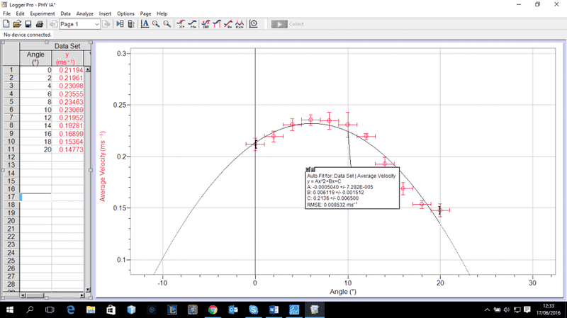

I'm completing my IB Physics IA and after collecting my data and plotting the raw graph my graph seems to be a negative parabola.
In order to linearize it I though one had to square the x-axis data; however I simply get the same graph shape.
What am I supposed to do?
Only when I plot the following I get a straight line [y-axis data = y and x-axis data = x]:
y/x against 1/x.
Why is this? How do I linearize this graph?
Thankyou!

Thank very much for the quick replies, I've attached my raw data graph to this reply.
I'm attempting to linearize how the heeling angle of a boat affects its velocity.
Moreover I've already attempted to raise the data to a different power [up to 10] against the other variable however this doesn't seem to work either.
The data is also on the left hand side if you would like to attempt to try something out.
Thank you very much in advance!
The data seems to have a nicely behaved maximum and the data points are evenly spread along the curve. What would be the purpose of "linearising" the graph? (Or do you mean something different from what I am thinking?)

When you attempted to linearize this by squaring the x coordinate, did you square the raw value or did you square its displacement from the midpoint of the fitted parabola?
Also, since the x-axis is angle, I would expect something that goes as cos(x) or cos2(x) more than x2.
I squared the actual raw data [or coordinates if you will] for example for the first data point 0.21194 I squared that and proceeded to do that for all the other points and then plotted that however I only obtained the same shape of the curve

That doesn't work as your equations is of the form
y = ax2 + bx + c
I'm not sure how you linearize a quadratic that has a bx term.

In order to get a proper result, you should square the offset of each point from the fitted center of the parabola and re-draw the graph using those results.

Plot y vs (x-6.07)2.
