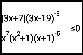

Inequality shown as a fraction: numerator |3x+7|(3x-19) raised to the power -3, denominator x^7(x^2+1)(x+1) raised to the power -5, the fraction is less than or equal to 0.
Solving Polynomial Inequalities
Then I used the property of absolute value inequality to get rid of it.
But I really don't know if I'm doing the right step. Is this correct? So that I could separate them in two cases and find the solution set.

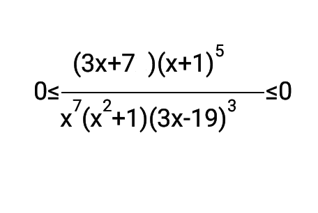

Handwritten-style rational inequality 0 ≤ (3x+7)(x+1)^5 / (x^7(x^2+1)(3x-19)^3) ≤ 0, with the fraction between the two inequality signs.
Divide it into two alternative cases.
(1) It's equal to zero. This is the easiest one. What can we say about x in that case?
(2) It's less than zero. What does that imply about the signs of the numerator and the denominator. Is there any part of either that we can ignore?

Hello moondaaay. Welcome to PF !
Where is the function on the left side of the inequality zero?
What is its domain?

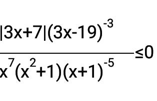

Rational inequality: numerator |3x+7|(3x-19)^-3, denominator x^7(x^2+1)(x+1)^-5, the fraction is less than or equal to 0.
The inequality has four critical values for x, splitting the real number line into five intervals. Each interval can be checked to find which are solutions to the inequality and which are not solutions.
But what should I do first to remove the absolute value?
Not really important here. Whatever sign the 3x+7, its absolute value will still be POSITIVE OR ZERO.
