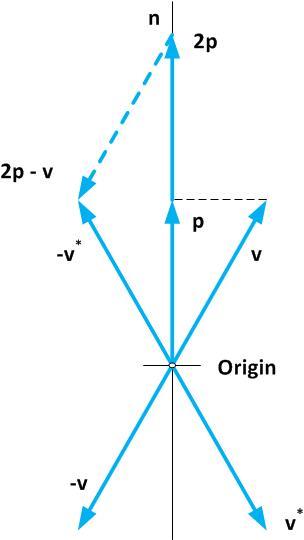

sakkid95
Question link: http://gyazo.com/4d52ab2521e5b222241718ea1b7ccb08.png
I have to solve this using vectors, not geometry
My professor said the equation that's required is -v* = 2 proj v onto n - v
and v* is reflected vector, so I don't really understand how to do this
First off I don't understand how to use the equation itself, our teacher hasn't done any examples, he just showed us how he derived the equation
My attempt
I found proj of v onto n for the first line was (0, x+a) x is first x value for mirror but I'm not really sure how I'm supposed to subtract the vector, and then I also don't understand how we're supposed to find cotangent in our solution.
If anyone could help explain what I'm supposed to do, I'd be very grateful, thanks.

i think he's expecting you to find the magnitude of 3[v - (v.n)n] by squaring it :wink:

For 2. relevant equations -v* = 2 proj v onto n - v might do the trick, but I have to admit my english isn't up to translating that into either words or something mathematical that I can work out. Who is n ? Who is v ? Prof showed how he derived the equation. Did you understand what he meant? Can you rephrase or draw what you picked up from this showing ?

OK, I have consulted a projontologist and he drew a few arrows on the blackboard (to do so he had to erase a few equations that looked like failures: [strike]E=ma2[/strike] [strike]E=mb2[/strike] ;-)
v is the first trajectory of your ray, from S to M1.
n is parallel to the normal to M1.
p is the newly learned projonton.
(Dashed line is v-p and its length is part of our x anwer!)
2p is twice p.
-v is just that: take v and put a - in front of each component (can only do that in a cartesian coordinate system!)
2p-v is start at the end of 2p and move by -v
Teacher has shown you end up at -v*
do the minus thing and voila v* !
Of course you want it to originate from the end of v, but that can be done easily: just shift it where you want it -- without changing size nor orientation.
Recognize any of this ? If not, ask or read up on it!
