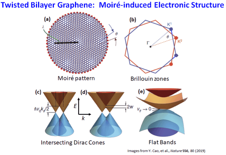

A picture will help:
The easiest way to think about it is in two steps:
1) Start by assuming the two graphene layers don’t interact. Then the Brillouin zone of the system will be two hexagons twisted relative to one another in reciprocal space by the same angle that the graphene layers are twisted in real space (Figure b above). The band structure of the total system will feature the Dirac cones twisted relative to one another, and the level crossings that occur due to the twisting of the cones will have an angle-dependent energy (Figure c, left diagram).
2) Add in interaction between the two layers. This turns the Dirac cone level crossings into avoided crossings, with a characteristic energy that is more or less constant (Figure c, right diagram).
At a certain “magic” angle, the interlayer interaction energy from step 2 and the angle dependent energy from step 1 will be equal. This causes the extremely flat avoided crossing bands to land right at the Fermi level (Figure d), leading to an increase in the density of states by several orders of magnitude. BCS tells us that increasing the density of states at the Fermi level increases the superconducting critical temperature.
