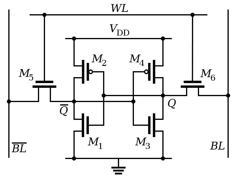

I have computer science minor, and we have been given the task of finding out the differences between SRAM and DRAM. Simple enough? I thought so, until I got into the circuitry of a SRAM cell and got interested in finding how it works for storing, reading and writing data. Unfortunately I could not find a good website that explains this properly.
The diagram, taken from Wikipedia, is this one:
From Quora, M5 and M6 are access transistors, M2 and M4 pull up, M1 and M3 are pull down transistors. WL is probably a "word line" (read from somewhere else) which has to be high to allow a read and write operation.
On reading the explanation at Wikipedia, I have the following questions:
1. The M# are transistors, but why have they been drawn like that? We learned to draw transistors in a different way, isn't it?
2. Wikipedia states in the reading section,
In theory, reading only requires asserting the word line WL and reading the SRAM cell state by a single access transistor and bit line, e.g. M6, BL. However, bit lines are relatively long and have large parasitic capacitance. To speed up reading, a more complex process is used in practice: The read cycle is started by precharging both bit lines BL and BL, to high (logic 1) voltage. Then asserting the word line WL enables both the access transistors M5 and M6, which causes one bit line BL voltage to slightly drop. Then the BL and BL lines will have a small voltage difference between them. A sense amplifier will sense which line has the higher voltage and thus determine whether there was 1 or 0 stored.
Why will the voltage difference come?
They are MOSFETs. P-channel and N-channel FETs. Do you have a guess why FETs are used for high-density RAM ICs instead of Bipolar transistors? :smile:
Although I don't have too much knowledge on FETs, I believe the fact that FETs are voltage controlled rather than current controlled makes them superior to BJTs. Current-controlled biasing means more power consumption.

The 4 transistors, M1,M2,M3,M4 can be in two stable states, one where Q is high and Qbar is low, and one where Qbar is high and Q is low. If Q is high and Qbar is low, then M1 is on and M3 is off. When the WL is pulled high, both M1 and M5 are on, so current will flow from BLbar through M5 and M1, pulling BLbar down. Since M3 is off, no current will flow through M6 and M3, so the voltage on BL does not change. So a voltage difference develops between BL and BLbar, with the voltage on BL staying high and the voltage on BLbar dropping. In the opposite state, BLbar stays high, and BL drops. Does this make sense?

Yes, thanks for the explanation. One question: you explained this with M1 and M3, without using M2 and M4. How are the latter useful in the circuit?
M2 and M4 don't take part in the reading operation. Their purpose is to maintain the two stable states. Take the case when Q is high and Qbar is low. Then M3 is off. When not reading, WL is low, so M5 and M6 are off. Then there is nothing to hold Q high, so over time the charge on Q will gradually leak away. But when Qbar is low, M4 is on, so it holds node Q high. This is why it is a static RAM, because it will hold information indefinitely, as long as power is supplied.

This works because the bit line input-drivers are designed to be much stronger than the relatively weak transistors in the cell itself so they can easily override the previous state of the cross-coupled inverters. In practice, access NMOS transistors M5 and M6 have to be stronger than either bottom NMOS (M1, M3) or top PMOS (M2, M4) transistors. This is easily obtained as PMOS transistors are much weaker than NMOS when same sized.
In what sense are the PMOS weaker than NMOS?
Wrichik Basu said:
While describing the write process, Wikipedia states, In what sense are the PMOS weaker than NMOS?
Look at the equation for the MOSFET current:
{\displaystyle I_{\text{D}}=\mu _{n}C_{\text{ox}}{\frac {W}{L}}\left(\left(V_{\text{GS}}-V_{\rm {th}}\right)V_{\text{DS}}-{\frac {{V_{\text{DS}}}^{2}}{2}}\right)}
The μ term is the carrier mobility. In silicon, the hole mobility is about 1/3 of the electron mobility, so all else being equal, the PMOS are much weaker. As for the NMOS, the SRAM cell is usually designed so M5 and M6 have wider W than M1 and M3.
