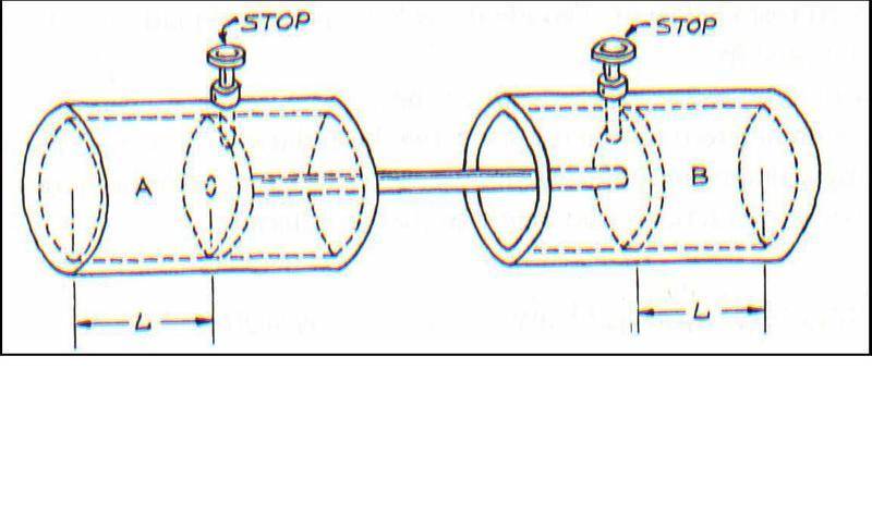

I am stuck on the following problem:
"Two well-insulated cylinders are placed as shown in Figure . The pistons in both cylinders are of identical construction.
The clearances between piston and wall are also made identical in both cylinders. The pistons and the connecting rod are
metallic.
Cylinder A is filled with gaseous helium at 2 bar and cylinder B is filled with gaseous helium at 1 bar. The temperature
is 300 K and the length L is 10 cm. Both pistons are only slightly lubricated.
The stops are removed. After all oscillations have ceased and the system is at rest, the pressures in both cylinders are,
identical.
1. Assuming that the gases are ideal with a constant Cv and assuming that the masses of the cylinder and pistons are
negligible (any energy changes of pistons and cylinders can be neglected), what are the final temperatures?
2. Consider the situation with well-insulated pistons and connecting rods of low thermal conductivity. What are the
final temperatures after the oscillations have ceased and the pressures have equalized?"
Any help would be greatly appreciated.

In Q1, what is the significance of a metallic connecting rod ?
The metallic rod is basically used to transfer any heat produced from the oscillations from one piston to the other.
PArt 2 should be considered as an adiabatic reversible process due to the low thermal conductivity of the rods.

The total internal energy of the system does not change. The work done on cylinder 2 is:
[tex]W = \int_{vi}^{vf} Pdv = \int_{vi}^{vf} \frac{nRT}{V}dv[/tex]
If the two cylinders are thermally connected, as in the first question, what can you say about the temperature?
The second question is a little trickier. The total energy is conserved but this time the internal energy of the gas in each cylinder changes by the work done by or to it.
The incremental decrease in internal energy in cyl1 will be [itex]dU_1 = n_1CvdT_1 = PdV_1[/itex] and incremental increase in cyl2 is [itex]dU_2 = n_2CvdT_2 = PdV_2[/itex]. From that, keeping in mind that PdV is the same in each case and total energy does not change, you should be able to determine the change in temperature.

Well, see if you can work it out:
(1)[tex]nC_vT_1 + 2nC_vT_2 = U_f = U_i = 3nC_vT_i[/tex] and
(2)[tex]nC_v(T_1-T_i) = 2nC_v(T_2-T_i)[/tex]
and, using PV/T = nR = constant, you should get:
(3)[tex]\frac{V_{1f}}{V_{2f}} = \frac{T_{2}}{T_{1}}[/tex]AM
I misled you on this. If the connecting rod does not conduct heat, there is no transfer of heat from either chamber so this appears to be an adiabatic process, to which the adiabatic condition applies:
[tex]PV^\gamma = constant[/tex]
So you should get:
[tex]\frac{V_2^{\gamma-1}}{V_1^{\gamma-1}} = \frac{T_1}{T_2} =[/tex] and
[tex]V_1^{\gamma} = 2V_2^{\gamma}[/tex]
This should enable you to solve it.
