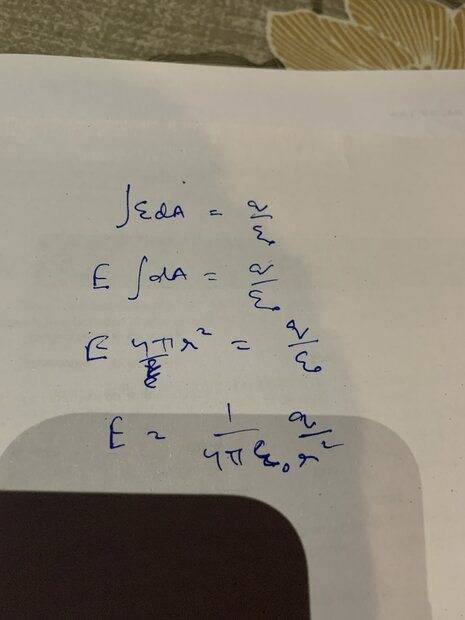

This is a spherical shell which I assume is very thin. That is why we took R as radius. Now we are trying to find E due to this shell at S2. I have done it attached in picture. Here we have taken out E as a constant. That means E produced at S2 is constant at all points.
I want to ask how?
I know field will be constant if it’s a point charge at the center but how is field constant due to a charged shell.

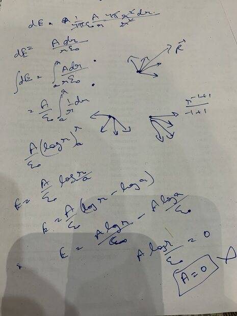

Also I have tried to do the above problem another way but it’s not coming. A is coming zero is wrong. How can we do it by first finding dE and then summing up all dEs.

The strategy we use is:
i) find a formula for |E| as a function of r (where a≤r≤b);
ii) using a bit of algebra, find an expression for 'A' which removes r from the formula for |E|.
We find a formula for |E| as a function of r in order that we can then figure out how to choose A so our formula no longer contains r (which makes |E| is independent of r).
I can’t see any other sensible strategy.
It's worth noting that the constant value of |E| will be whatever |E| is when r=a. So we know (e.g. using Gauss’s theorem) that ##|E| =\frac {q_0}{4 \pi \epsilon_0 a^2}## where ##q_0## is the central charge.
It's also worth noring that the value of b is irrelevant! The answer is true for any value of b (as long as b>a).
