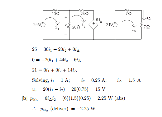

Use the mesh-current method to find v0.
Find the power delivered by the dependent source.
v1+v2+..vn=0
i=v/R
p=iv
eq #1)-i1*10+i2*20=25V
eq #2) i2*20+i2*24+6iΔ=0
eq #3) iΔ*14=21
eq#3) iΔ=1.5A
eq#3 sub into eq#2) i2=0.204A
i2 sub into eq#1) -1.6A
Power delivered=
p=iv
p=0.204A*(6*1.5)V = 1.839 W
I posted the solution below. I don't understand how they got it. They added up resistances, and also said i1*20 in the first equation, but i2*20 in the second. Also, I'm not sure how to get the polarities when the + and i signs aren't given. For example, the 24Ω resistor.
  • Three-mesh circuit schematic with a 25 V source and 10 ohm resistor in the left mesh, a 24 ohm resistor, 20 ohm resistor and dependent source 6i_Δ in the middle, and a 21 V source with 7 ohm resistors on the right, with currents i1, i2 and i_Δ labelled, followed by the mesh equations and solved values.
You are not applying mesh analysis correctly. The currents denoted as i1 and i2 are loop currents, this means each flows in a closed loop, so it's best that you show them doing so by marking in each loop current as a complete circle even though the sample answer has set a poor example by not doing so.
When done properly, you can see that the current in the 10Ω resistor is i1, and the current in the 20Ω resistor is the sum of two currents: i1 down and i2 upwards, making it (i1 - i2) total. So the voltage across the 20Ω resistor is going to involve that current, the resistor's total current.
Make a fresh start. Ignore the calculations shown in the sample answer, for the time being.
