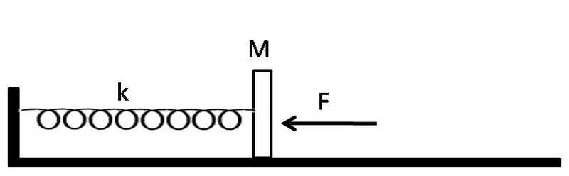

Question 1)
In the figure below, k=100 N/m, M=1 kg and F=10N. A sharp blow by some external agent imparts the speed of 2 m/s to the block towards left. Find the amplitude of the resulting simple harmonic motion.

For the first Question 1, i used the energy conservation to solve the problem.
Firstly, i found the initial compression in the spring and then formulated the equation as:-
[tex]\frac{1}{2}Mv^2+\frac{1}{2}kx_o^2=Fx+\frac{1}{2}k(x+x_o)^2[/tex]
xo=Initial compression in the spring
v=velocity imparted to the block
x=Distance which the block covers after the velocity is imparted (This will be the amplitude)
Now when i plug in the values, i don't get the answer stated in answer key. I don't understand where i am going wrong.

I don't think that you need to know the value of the force F to find the amplitude of the oscillation.
Do you know how to calculate angular frequency from the information you have been given?
Do you know an expression for maximum velocity in SHM

Yes, i can find out the angular frequency from the given information.
Here,
[tex]T=2π\sqrt{\frac{m}{k}}[/tex]
Substituting the values, i get T=pi/5 sec.
Since, angular frequency,ω=(2pi)/T, therefore ω=10 rad/sec.
XD I've got it how to do this now. Now, vmax=Aω and vmax=2 m/s, A=0.2m.

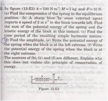

By initial, i mean before the blow. "F" is given in the question as 10N. I have used this "F" to find the compression before anything else has happened.
By the way, this is not the exact question. It is a sub question and i got stuck at finding the amplitude. If you wish to check the complete question, you could check the question in the image below:-
Hi Pranav,
Thank you for showing the whole problem. It is quite clear now!
I am sure you could answer questions a,b,c.
The sudden blow means that a very high force acts for such a very short time so that the displacement of the block is negligible during the action. The block stays at the equilibrium position, xo=0.1 m while gains speed. It is only approximation. You could determine the change of position if the force have been given.
The problem with that constant force is identical with the situation when a body hangs on a spring. Because of gravity, the spring stretches by xo=mg/kl and oscillation will occur around that equilibrium position. If Δx=x-xo, Δx=Asin(ωt) and ω is the same as for the unstretched spring, ω=sqrt(k/m).

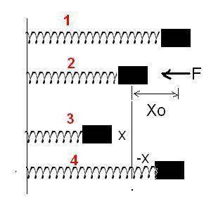

When there is a constant (compressive) force exerted on the mass on spring the length of the spring changes as L(t)=Lo-xo-Asin(wt). It means an SHM around the new equilibrium length Lo-xo.
In the figure, 1 shows the original length of the spring. 2 is the spring, compressed by the constant force F. 3 is the state of maximum compression after the blow, 4 is the minimum compression. The block oscillates between these positions with amplitude x.
I will try to make you a moving gif picture tomorrow. :smile:

Thank you for that image, i understand better now. I was confusing with the mean position, thanks for the clarification. :)
