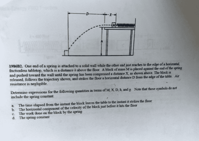

Attached image below!
Conservation of energy, kinematic equations
d) The block of mass m is pushed toward the wall until the spring has been compressed, and so the spring has stored PE, and when the block is released, it follows a projectile motion and strikes the floor ##stored PE\rightarrow K.E ##.
By law of conservation of energy,
$$ E_i = E_f $$
$$ mgh + \frac{1}{2}kx^2 = \frac {1}{2}mv_f^2$$
$$ k = \frac{2m}{x^2} (\frac {v^2}{2} - gh)$$
a) The time elapsed from the instant the block leaves the table to the instant it strikes the floor is taken as ##\Delta t##.
$$ E_i = E_f $$
I replace ##v_f## in the above equation with range D over elapsed time.
$$mgh + \frac{1}{2}kx^2 = \frac{1}{2}m \frac{D^2}{\Delta t^2}$$
In the above equation I substitute for k which I got from part d.
$$\Delta t = \sqrt {\frac {D}{V}}$$
b) When the block takes a projectile motion, it has uniform motion at constant velocity in the horizontal direction.
There fore ## (v_x)_f = (v_x)_i## = constant
c) The work done on the block by the spring is given by
$$ W.D_{sp} = \frac{1}{2}kx^2$$
Substituting k in the above equation we get,
$$ W.D_{sp} = m (\frac {v^2}{2} - gh)$$
Have I done it right?
Doesn't look right to me.
For part d first figure out the velocity of the block at the top of the table, then just apply kinematic relationships.

Distance fallen by a mass is given by
$$\Delta y = v_{iy} t - \frac{1}{2}gt^2$$
$$\Delta y = -\frac{1}{2}gt^2$$ since v_{iy} = 0
The block when released has initial constant velocity, it covers a distance D,
$$ \Delta x = v_{ix}t + \frac{1}{2}at^2$$
$$ \Delta x = v_{ix} t$$ where a =0
$$ v_{ix} = \frac{\Delta x}{t}$$
Better.
Now substitute the given variables M, D, x, as appropriate and find ##v_{ix}##.

using law of conservation of energy,
$$mgh +\frac{1}{2}kx^2 = \frac{1}{2}mv_{ix}^2 +mgh$$
$$v_{ix} = \sqrt {\frac {k}{m}} x$$
sSubstituting for ##v_{ix} =\frac {D}{t}## in the above equation we get for k is
$$k =\frac{D}{t} ^2 m x$$
The above equation is D squared over t squared.

$$ v_{ix}t = D$$
You have an expression for ##v_{ix}##, and you have an expression for ##t## from falling a distance ##h##.

Okay,
$$ h = \frac{1}{2}gt^2$$
$$ t = \sqrt {\frac{2h}{g}}$$
Substituting t in equation for v_{ix} we get
$$ D = v_{ix} \sqrt {\frac{2h}{g}}$$
paulimerci said:
Okay,
Right. Now combine that with an equation relating ##v_{ix}## to k.
$$\frac{1}{2}kx^2 = \frac{1}{2}mv_{ix}^2$$
substituting ##v_{ix} = D^2 \frac{g}{2h}## in the above equation
$$k = m\frac{D^2}{x^2} \frac{g}{2h}$$
In the above equation x is squared.

work done on the block by spring
$$W{sp} = \frac{1}{2} kx^2$$
$$ W{sp} = \frac {mD^2g}{4h}$$

$$ k = m\frac{D^2}{x^2} \frac{g}{2h}$$
You mean ##v_{ix}^2 = D^2 \frac{g}{2h}##.
paulimerci said:
$$k = m\frac{D}{x}^2 \frac{g}{2h}$$
So write $$k = m(\frac{D}{x})^2 \frac{g}{2h}$$ or $$k = m\frac{D^2}{x^2 }\frac{g}{2h}$$
