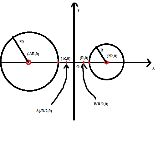

Two uniformly charged spherical shells of radii R and 2R with identical surface charge densities σ are along the x-axis. The surface of each of the spheres is located a distance R from the origin O
Define the potential at ∞ to be zero.
Along the x-axis are two locations A and B that are R/2 from the Origin (O).
A) What is the potential at A?
B) What is the potential at B?
C) Work required by external foce to move a charge q from A to B?
D) Where between the spheres and along x-axis is the potential the minimum?

also my teacher did not provide me with a picture or any diagram so I'm kinda visualizing it in my head. HELP ME PLEASE!
Check out the attachment. Maybe this is what the diagram may look like.

In the diagram, A is R/2 from the origin. So its distance from the center of the 2R sphere is 5r/2. And its distance from the R sphere is again 5R/2. So you have to find VA as the sum of the two potentials because of the two spheres.
To find the point where the potential is minimum, consider a point (x,0). Find its potential. Differentiate the expression w.r.t. x and equate to zero. You'll get a value of x where the potential is minimum.

wait hows it 5R from the origin? The center of the 2R sphere is 3R from the origin? and the center of R sphere is 2R from the origin?
How's what 5R from the origin?
You said the distance from the center of the 2R sphere is 5r/2. And its distance from the R sphere is again 5R/2. i don't understand how its 5R from the point of the sphere to the origin (0,0) on the graph
also what does the expression w.r.t. mean
I'm really sorry for my poor use of grammar there. Let me explain again. From the center of the sphere of radius 2R, the distance of A is 5R/2 right? Also from the sphere of radius R, the distance of A is 5R/2. So now find the potential at A because of the two spheres.
w.r.t means with respect to. Differentiate the expression for potential at (x,0) w.r.t. x and equate it to zero to obtain the x where the potential in minimal.

i see. so for point b, the two spheres would have different distances right?
Yes. Point B would have different set of distances from the centers of the spheres. Find the potential there too.
I hope you have understood how to obtain the point where the potential is minimum.

Since their radius is different, won't the charges be different because the areas are not the same.
In the potential equation I recommend you take the the distances as |3R-x| and |2R-x|. Then you can take cases to find the potential when x>2R, -3R<x<2R and x<-3R.
Once you get the potential, for each interval of x ( as I have divided in my previous sentence), differentiate the expression w.r.t. x and equate that to zero. You should get some values of x corresponding to dV/dx = 0. Substitute them in the original equation and find the potential. Choose the minimum potential and the answer to the question would be the corresponding value of x.

You take the derivative of the sum (i.e. the net potential) and then equate it to zero.
that derivative seems tough. do i use the quotient rule for that?
Yes you have to use quotient rule and the derivative is not tough. You should be able to do it within a couple of steps. (Remember k and Q for a sphere is constant, so you're simply finding the derivative of 1/distance.)
