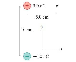

The diagram is attached. What is the strength of the electric field at the position indicated by the dot in Figure 1? What is the direction of the electric field at the position? Specify the direction as an angle measured clockwise from the positive x axis.

  • Diagram of two point charges: a positive 3.0 nC charge at top left and a negative -6.0 nC charge at bottom left, 10 cm apart vertically, with a dot 5.0 cm to the right of the positive charge; a set of x and y axes is shown below the dot.

The problem is that this is not the angle of the electric field vector. The angle is found from the components of the electric field vector, not the distances to the charges. You should first find the x and y components of each vector and add up those components. What do you get when you do this?

The most direct way is to not worry about finding the angle first and write everything in terms of unit vectors instead. Remember the Electric field vector is given by
$$\mathbf{E}=k\frac{q}{r^{2}}\hat{r}$$
##\hat{r}## is the unit vector telling you the direction of the electric field. In this case ##\hat{r}## points along the hypotenuse of the triangle created by the two charges and the dot. To find ##\hat{r}## you need to take the components of the vector ##\mathbf{r}## and divide them by the length of ##\mathbf{r}##.
$$\hat{r}=\frac{\mathbf{r}}{|\mathbf{r}|}=\frac{5\hat{x}+10\hat{y}}{\sqrt{5^{2}+10^{2}}}=0.447\hat{x}+0.894\hat{y}$$
Now that you have ##\hat{r}## what is the electric field produce by the -6.0nC charge at the location of the dot?

You are missing the negative sign on ##q##. Including it gives the field from the negative charge as
$$\mathbf{E_{-}}=-1928.89\text{N/C}\;\hat{x}-3857.79\text{N/C}\;\hat{y}$$
