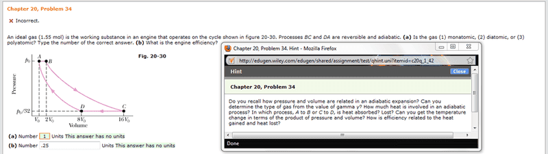

I know I have to find the gamma firstly in order to determine what type of gas is present here. And to do that I have to pick one of the adiabatic processes. I chose to do AD. But I am literally lost at how to set this up because we aren't really given values and reading graphs is not one of my strong suits in physics.
Note - The green in picture means "Correct". I just input 1 for the gas and .25 for the efficiency off guessing.

To calculate the efficiency use:
ε = W/Qh = (Qh-Qc)/Qh
First, find the temperatures at A, B, C and D in terms of P0, and V0.
Then using the adiabatic condition expressed in terms of T and V, work out Cp/Cv. You will then be able to find Qh and Qc from the graph (for the constant pressure processes dQ = nCpdT) in terms of P0 and V0.

Do you mean using the ideal gas law PV = nRT?
Point A Temperature:
PoVo = 1.55*8.31*T
T = PoVo/12.8805
Point D Temperature:
(Po/32)*8Vo = 1.55*8.31*T
T = PoVo/51.522
Is this what you were saying?

Yes. Calculate T at B and C now using the same method. But show the relationships between them:
[tex]T_D = 8T_A/32 = T_A/4[/tex]
