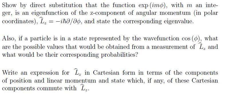

Hi, my problem is with part two of the question I've attached. I'm not exactly sure what they are expecting me to do, is it simply calculating the expectation value of L_z , from the wavefunction given (i.e. cos(φ))
Thanks.

Not sure what part you have a problem with. I am assuming the 2nd paragraph. They basically want you to decompose the cosine into a superposition of eigenfunctions. The magnitude squared of the coefficients for each eigenfunction will give you the probability of that state.

Oh yes, forgot about decomposing cosine and sine.
I got another question, which is, if given a wave function like
u = Acosine(Pi/2a) + B sin(Pix/a)
How would I sketch the form of this squared (i.e. the probability distribution)?
The first term looks like a constant, so you would just sketch the 2nd term and have it raised or lowered vertically by a constant. Unless you mistyped the first term.
