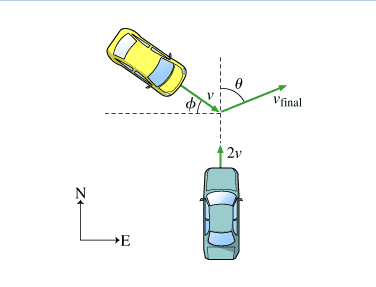

Two cars, both of mass m, collide and stick together. Prior to the collision, one car had been traveling north at speed 2v, while the second was traveling at speed v at an angle phi south of east. After the collision, the two-car system travels at speed v_final at an angle theta east of north
Find the speed v_final of the joined cars after the collision.
Express your answer in terms of v and phi.
i am dividing the velocity into components using x-component and y-components of v.
vx = vcosθ
vy = vsinθ
then finding the magnitude, v = (vx^2 + vy^2)^1/2
ok so my two equations are
vx = vcos and vy = 2v - vsin
after trying to find the magnitude i found the answer v(5-4sinθ)^1/2 but it says the answer is not right.
i am using θ instead of phi
There is no question in the problem statement. What do you need to find? This smells like an inelastic collision scenario requiring use of the principle of conservation of linear momentum.
Yeah, use conservation of linear momentum as it relates to collisions. Should be in your book.
