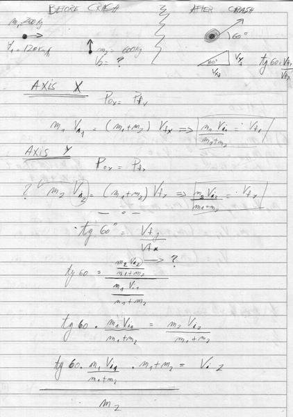

A motorcycle with a mass of m1 = 200 kg and a speed of v1 = 120 km/h collides with a car of mass m2 = 600 kg, traveling in a perpendicular direction to the motorcycle. After the collision, both vehicles travel in a direction that forms an angle of 60°.
Find the initial velocity of the car.
P = m * v
I = Pf - Pi
So basically I would need to know if what I did is ok. I have attached the attempt at the solution. Thansks in advance guys!
I first calculated the momentum of the motorcycle before the collision:Pm = m1 * v1 = 200 kg * 120 km/h = 24000 kgm/hThen I calculated the momentum after the collision, using the conservation of momentum:Pfin = Pm + Mc = 24000 kgm/h + 600 kg * vc = 24000 kgm/h + 600vSince the momenta are conserved, I set the initial and final momentum to be the same:24000 kgm/h = 24000 kgm/h + 600v600v = 0Therefore, the velocity of the car is 0.
