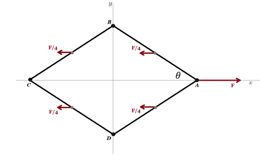

Adesh said:
But can you please explain this part with the help of diagrams?
The centre of mass is at the centre of the rhombus. ##\theta## is the angle BAC.
@Adesh
Hope this helps clear things up for you
FIGURE FOR PART 2 LOADING
@Chestermiller Just one little doubt:
Chestermiller said:
From this, it follows that the x-velocity of vertex A relative to the center of mass of the rhombus is
vAx=−bsinθdθdt​
How we got the minus sign?
We can move on now. Everything is cleared till that far.

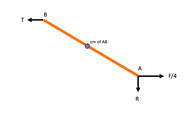

We next focus on the dynamics. This starts with the free body diagram for member AB:
The above FBD shows the forces acting on strut AB. The tension F/4 at pin A is the portion of the imposted load F/2 that acts on strut AB. The tension R at pin A represents the contact force that strut DA imposes at A to keep vertex A from moving in the y direction. The tension T at pin B represents the contact force that strut CB imposes at B to pull vertex B back.
Next, we write the Newton's 2nd law force- and moment balances on strut AB. The force balances on AB in the x- and y-directions, respectively (based on the free body diagram) are:
$$\frac{F}{4}-T=ma_{cmx}=m\frac{a_{Ax}}{2}\tag{1}$$
$$-R=mA_{cmy}=-m\frac{a_{Ax}}{2}\tag{2}$$where use has been made here of some of the kinematic relations in post #29 to express the acceleration components of the center of mass of strut AB in terms of the x-direction acceleration of vertex A relative to the center of mass of the overall structure.
A clockwise moment balance on strut AB about its center of mass gives:
$$R\frac{b}{2\sqrt{2}}-\frac{F}{4}\frac{b}{2\sqrt{2}}-T\frac{b}{2\sqrt{2}}=I\frac{d^2 \theta}{dt^2}\tag{3}$$where I is the moment of inertial of the strut about its center of mass: $$I=m\frac{b^2}{12}\tag{4}$$If we combine Eqns. 3 and 4, we obtain:
$$R-\frac{F}{4}-T=\frac{m}{3}\frac{b}{\sqrt{2}}\frac{d^2 \theta}{dt^2}\tag{5}$$But, from post #29, $$\frac{b}{\sqrt{2}}\frac{d^2 \theta}{dt^2}=-a_{Ax}$$Therefore, $$\frac{F}{4}+T-R=\frac{m}{3}a_{Ax}\tag{6}$$
If we now combine Eqns. 1,2, and 6 to eliminate T and R, we obtain: $$a_{Ax}=\frac{3}{8}\frac{F}{m}$$Based on this and the results of Part 1 loading, we find that the absolute acceleration of vertex A is ##\frac{F}{4m}+\frac{3}{8}\frac{F}{m}=\frac{5}{8}\frac{F}{m}## and that the absolute acceleration of vertex C is ##\frac{F}{4m}-\frac{3}{8}\frac{F}{m}=-\frac{1}{8}\frac{F}{m}##

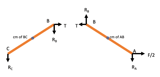

I've decided that I'm done screwing around with this problem. I'm going to solve it only using the laboratory (fixed) frame of reference, and without using the resolution of the problem into two separate problems that I've done so far. To do this, I'm going to focus on the top half of the truss, and do force and moment balances of struts AB and CD.
First the kinematics. There are only two parameters that characterize the kinematics of this problem. This is the angle ##\theta## and the location of the center of mass of the overall rhombus. Using the analysis and notation in post #29, the acceleration components of the center of mass AB are:
##a_C+a_{Ax}/2## in the x direction
and
##-a_{Ax}/2## in the y direction
And for strut BC, they are
##a_C-a_{Ax}/2## in the x-direction
and
##-a_{Ax}/2## in the y direction##
where ##a_C## is the x-direction acceleration of the center of mass of the overall truss.
The figure below shows the free body diagram for the two struts comprising the upper half of the truss:
Based on this, the force- and moment balances on strut AB are:
$$\frac{F}{2}-T=m\left(a_C+\frac{a_{Ax}}{2}\right)$$
$$R_B-R_A=-m\frac{a_{Ax}}{2}$$
$$(R_B+R_A)\frac{b}{2\sqrt{2}}-\left(\frac{F}{2}+T\right)\frac{b}{2\sqrt{2}}=m\frac{b^2}{12}\frac{d^2\theta}{dt^2}$$
And for strut BC, they are:
$$T=m\left(a_C-\frac{a_{Ax}}{2}\right)$$
$$R_B+R_C=m\frac{a_{Ax}}{2}$$
$$-(R_C-R_B-T)\frac{b}{2\sqrt{2}}=-m\frac{b^2}{12}\frac{d^2\theta}{dt^2}$$
OK so far?

OK. Continuing with the analysis, if we add the force- and moment balances for the two struts together, we obtain the following:
$$\frac{F}{2}=2ma_C\tag{1}$$
$$2R_B+R_C-R_A=0\tag{2}$$
$$2R_B+R_A-R_C-\frac{F}{2}=0\tag{3}$$
From Eqn. 1, if follows that $$a_C=\frac{F}{4m}\tag{4a}$$From Eqns. 2 and 3, it follows that $$R_B=\frac{F}{8}\tag{4b}$$
Eqns. 4 are identical to the relationships obtained previously for Part 1 loading. So adding the force and moment balance equations for the two struts is found to deliver the exact same equations as for Part 1 loading.
From Eqn. 2, it follows that $$\frac{(R_A-R_C)}{2}=R_B=\frac{F}{8}\tag{5}$$
Now, with no loss of generality, we can then also write:
$$R_A=R+R_B\tag{6a}$$
$$R_C=R-R_B\tag{6b}$$ where $$R=\frac{(R_A+R_C)}{2}$$
Next, subtracting the force and moment balances of the two struts and combining these with Eqns. 6 yields:
$$\frac{F}{2}-2T=ma_{Ax}\tag{7a}$$
$$2R=ma_{Ax}\tag{7b}$$
$$\left(2R-2T-\frac{F}{2}\right)=2m\frac{b^2}{12}\frac{d^2\theta}{dt^2}\tag{7c}$$
Eqns. 7 are identical to the relationships obtained previously for Part 2 loading. So subtracting the force and moment balance equations for the two trusses is found to deliver the exact same equations as for Part 2 loading.

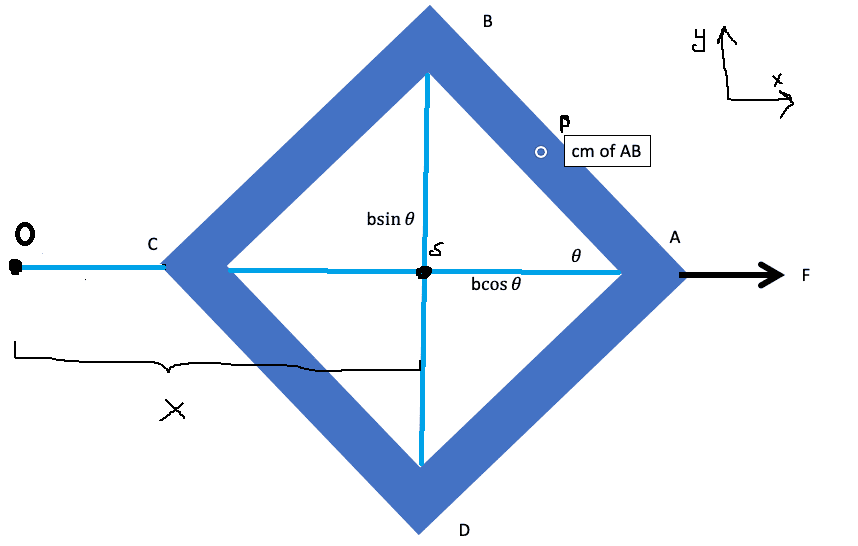

My 2 cents worth contribution to this beautiful thread.
Please note that I used the same approach that @wrobel at #21 and, to be fair, I checked it before getting the answer by myself.
I modified Chestermiller's nice diagram so that it can be applied to this approach
Where ##O## is at rest relative to the lab frame.
We first note that we have a time-dependent external force (exerted on A) which has no potential energy associated to it due to the fact that the force is not conservative.
At this point we think of the definition of generalized force (see for instance Classical Mechanics by Gregory, Chapter 12, page 337, definition 12.6)
$$Q_j = \sum_i \vec F_i^S \cdot \frac{\partial \vec r_i}{\partial q_j}$$
Where ##\vec F_i^S## is the specified force at a given point and ##\vec r_i## is the distance from ##O## to the given point.
Let's go step by step
1) Compute generalized forces
The generalized forces in this problem are:
$$Q_x = \vec F_A^S \cdot \frac{\partial \vec r_A}{\partial x}+\vec F_B^S \cdot \frac{\partial \vec r_B}{\partial x}+\vec F_C^S \cdot \frac{\partial \vec r_C}{\partial x}+\vec F_D^S \cdot \frac{\partial \vec r_D}{\partial x}$$
$$Q_{\theta} = \vec F_A^S \cdot \frac{\partial \vec r_A}{\partial \theta}+\vec F_B^S \cdot \frac{\partial \vec r_B}{\partial \theta}+\vec F_C^S \cdot \frac{\partial \vec r_C}{\partial \theta}+\vec F_D^S \cdot \frac{\partial \vec r_D}{\partial \theta}$$
Before computing anything we note that we've only been specified a force at A. Thus the rest are zero and we end up with:
$$Q_x = \vec F_A^S \cdot \frac{\partial \vec r_A}{\partial x}=F$$
$$Q_{\theta} = \vec F_A^S \cdot \frac{\partial \vec r_A}{\partial \theta}=-Fb \sin\theta$$
2) Determine the kinetic energy ##(T)## of the system
Note that we are going to work with two frames here: the lab frame (external observer) and the rhombic frame ##XYS##. König's theorem asserts that the kinetic energy of a system is the sum of two terms: the kinetic energy associated to the movement of the center of mass with respect to the lab frame (let me label it ##T_1##) and the kinetic energy associated to the movement of particles making up the system with respect of the center of mass of the system (let me label it ##T_2##).
- Let's determine ##T_1##: the center of mass (wrt the lab frame) is located at a distance OS, which is precisely our definition for the general coordinate x. Thus we get
$$T_1 = \frac 1 2 (4m) \dot x^2$$
- Let's determine ##T_2##: Let's first get the coordinates of the center of mass of the ##AB## rod
$$\Big( \frac b 2 \cos \theta, \ \frac b 2 \sin \theta \Big)$$
Then the velocity coordinates are
$$\Big( -\frac b 2 \sin \theta \dot \theta, \ \frac b 2 \cos \theta \dot \theta \Big)$$
Or in the more usual form: ##\vec v_{T_2}=-\frac b 2 \sin \theta \dot \theta \hat x + \frac b 2 \cos \theta \dot \theta \hat y##.
The nice thing here is that, although neither the coordinates nor the velocity coordinates of the other 3 rod's center of masses are the same as the ones for the ##AB## rod, the squared modulus of the velocity (##|\vec v_{T_2}|^2##) is.
$$|\vec v_{T_2}|^2=\frac{b^2}{4} \dot \theta^2$$
Besides, the rods possesses moment of inertia with respect to their center of mass (##\frac{mb^2}{12}## each), which means that we have to take into account the kinetic energy associated to the moment of inertia of all 4 rods.
Thus ##T_2## is given by
$$T_2=4 \Big( \frac 1 2 m \frac{b^2}{4} \dot \theta^2 + \frac{1}{24} mb^2 \dot \theta^2 \Big)=\frac{2}{3} mb^2 \dot \theta^2$$
Thus the kinetic energy ##(T)## of the system is
$$T = 2m \dot x^2 + \frac{2}{3} mb^2 \dot \theta^2$$
3) Compute the equations of motion related to each generalized coordinate
The Lagrange equations for a general standard system are:
$$\frac{d}{dt} \Big( \frac{\partial T}{\partial \dot q_j} \Big) - \frac{\partial T}{\partial q_j} = Q_j$$
- For ##x## we get
$$4m \ddot x = F$$
- For ##\theta## we get
$$\frac 4 3 mb \ddot \theta = -F \sin \theta$$
4) Get ##a_c##
Based on the diagram we see that
$$a_c=\frac{d^2}{dt^2} OC, \ \ \ \ \theta=\frac{\pi}{4},\ \ \ \ OC=x-b \cos\theta$$
Thus, using the equations of motion we've got, we end up with
$$a_c= \ddot x + b\cos \theta \ddot \theta^2 = \frac{F}{4m}-\frac{3F}{4m} \sin \theta \cos \theta=-\frac{F}{8m}$$
$$Q_{\alpha} = \vec F_A^S \cdot \frac{\partial \vec r_A}{\partial \theta}+\vec F_B^S \cdot \frac{\partial \vec r_B}{\partial \theta}+\vec F_C^S \cdot \frac{\partial \vec r_C}{\partial \theta}+\vec F_D^S \cdot \frac{\partial \vec r_D}{\partial \theta}$$
$$Q_{\alpha} = \vec F_A^S \cdot \frac{\partial \vec r_A}{\partial \theta}=-Fb \sin\alpha$$
- For ##x## we get
$$4m \ddot x = F$$
4) Get ##a_c##
Although, I couldn’t understand your solution (due to my lack of knowledge about Lagrangian Mechanics) but then also it was a beautiful solution, very well organised and clear.
