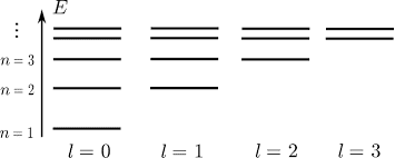

A. Write down the partition function for positronium, assuming that only the levels illustrated in the diagram exist. Evaluate the partition function for T=20000K. Remember to include the degeneracies for each level. (I couldn't figure out how to copy and paste the diagram I was given, so I googled the one below. It's the same diagram, but the diagram I was given stops at the N=3 energy level)
Energy level diagram of positronium with columns for l = 0, 1, 2, 3 and rows labelled n = 1, 2, 3 and dots above, energy E increasing upward; levels shown for each l are stacked, with fewer levels for higher l.
B. Write down an expression for the probability that the atom will exist in the state given by N=3, l=1, and determine that probability for T=20000K

A. So, we haven't done anything even close to this in class, so I'm a little coonfused, but to start, I substituted eq1 into the partition function in eq2 to get Z= ∑e-6.803eV (1 - 1/n2)/KT. After this, I'm completely stuck because we didn't really cover degeneracy in class very well. I know I'm supposed to multiply the expression by the degeneracy, but I'm not exactly sure how to do that.

You can treat the degenerate states like different states with a very similar energy (they just happen to have a difference of exactly zero here), I think. The real states are not degenerate either.

So for my n in my energy equation, I can just use the degeneracy?
and I've edited my post to include time zone, thanks!
So, I've rewritten the partition function using what I think is correct regarding the degeneracy.
Z= e-6.803(1-1/9)/KT + e-6.803(1-1/4)/KT + e-6.803(1-1/1)/KT
= e-6.047/KT + e-5.102/KT + e0
= (4)(1+ e-6.047/KT + e-5.102/KT)
I multiplied the partition function by 4 since it's four-fold degenerate.
am I at least on the right track?

I don't see where you used the degeneracy now.
Sorry, I should've multiplied the partition function by 4 since it's four-fold degenerate. Is that correct?
