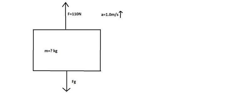

There is an attachment of a FBD, and you have to solve for the following:
Fg=?
Fnet?
Mass=?
I know you will have to equate equations, but I don't know how to go about doing this.
I do know that Fg= m x 9.8, I isolated various equations and subbed them into each other and got no answer.
  • Free-body diagram of a box with an upward applied force F=110N, a downward gravitational force Fg, mass labeled m=? kg, and acceleration a=1.0m/s upward.

Remember that the net force = mass X acceleration.
You have the acceleration, you have the two forces acting on the mass, and mass m.
You are almost there.

Fnet=ma
-Fg+F=ma
-9.8m+110 = m
-10.8m=-110
m=10.2kg
Fnet=-Fg+F
=-9.8m+110
=-9.8(10.2)+110
Fnet=10.04N
a= Fnet/m
a=10.04/10.2
a=0.98 m/s/s
Is this correct?
Looks good. However, you might use some more significant digits as the last part, a should be 1.0 as given.
