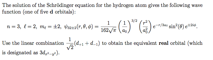

See attached photo
So I have no idea if I have even started this problem correctly so any help would be nice.
My working is set out in one of the pictures.
Any help would be appreciated I really am not quite sure what to do. Can't figure out where the x^2-y^2 comes from.
Thank you!
  • Printed text stating the Schrödinger hydrogen atom wave function for n = 3, l = 2, m = ±2 in spherical coordinates, with the normalised radial and angular factors and exponential, and the instruction to form the real orbital 3d(x²−y²) from the linear combination (d+1 + d−1)/√2.

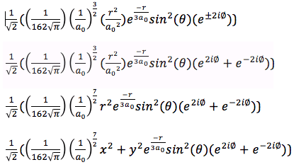

  • Four stacked lines of handwritten-style mathematics: wavefunction expressions in spherical coordinates with factors 1/sqrt(2), 1/(162 sqrt(pi)), (1/a0)^(3/2), r^2/a0^2, e^(-r/(3a0)), sin^2(theta), and e^(±2i phi) terms, ending with a line containing x^2 + y^2.

Hi KingBigness! :wink:
I'm guessing really, since this isn't my field :redface:, but if you replace r2sin2θcos2φ by r2sin2θ(cos2φ - sin2φ), that looks like x2 - y2 :smile:
Leave the r2 alone for now and use the fact that[tex]\cos \theta = \frac{e^{i\theta} + e^{-i\theta}}{2}[/tex]to get rid of the complex exponentials.
Thank you both for that, I shall try that and let you know how I go
Ok I tried that and out came the x^2-y^2
Thank you for that tip.
This is the answer I have ended up with can you let me know if it is correct or if I need to simplify it more? not really sure when to stop =\

I lied above...I brought the sin theta squared in before I converted which got rid of the sin theta squared in the final answer.
Is this now correct?
Yes, that's right, because in spherical coordinates x = r sin θ cos φ and y = r sin θ sin φ.
