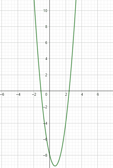

Draw a graph of the function ##f##. Alternatively, what might a total area of ##0## mean?
Graph of an upward-opening parabola crossing the x-axis at two points, with its minimum below the axis near x = 0.7 and a y-intercept near -8.
I have drawn the function. An area of zero means that it has to be two areas, one over x-axis, and one under, with the same area?
  • Graph of an upward-opening parabola crossing the x-axis at two points, with its minimum below the axis near x = 0.7 and a y-intercept near -8.
Yes, exactly. Starting from the y-axis in this case. If you changed the lower limit on the integral from ##0##, then you would be calculating the area from a different starting point.

Ohh, that gives so much sense. Thank you so much, PeroK. I have one last question, it's not a part of the task, but I'm just wondering. If I were to mark both of areas, how would I do it by looking at the function?
I'm sorry, Ray Vickson. I made a mistake when writing the equation here on the chat, the answer are correct though. I will fix it now.
I'm not sure that you mean. You can see with this function that it's not actually very easy to compare the different areas. In the end, computing the integral is the best way to compare areas, for all but the simplest functions.
I mean, if I were to express both of the areas with an integral, what would the limits on the integrals be? Would one of them have limits -2 and 0, and the other one would have the limits 0 and 4. I know that's wrong, but how am I supposed to find the limits?
What you found was that the integral from ##-2## to ##0## is zero; and, the integral from ##0## to ##4## is zero.
You can more or less see this from the graph.
I understand now. Thank you very much for your help, and not least for your patience. It takes some time for me to understand math, but you really helped me.
