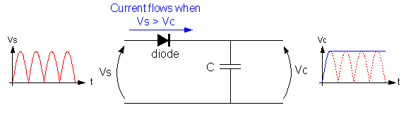

To summarize:
Half-wave rectifier circuit with a diode and capacitor C; left graph shows rectified sine input Vs, right graph shows capacitor voltage Vc holding near peak with small ripple.
Note that this assumes that there is no load connected across the capacitor (some device you want to power). If there is a load, the capacitor will supply current to it during the times that the source voltage is below the peak. This in turn will make the capacitor voltage "sag" a bit while it discharges into the load, but it will get topped up again when the supply voltage catches up. This is known as "ripple" on the average DC supplied by the circuit. So, not perfect DC but much better than the "raw" supply voltage. Bigger capacitors are better at smoothing the output.
  • Half-wave rectifier circuit with a diode and capacitor C, labelled Current flows when Vs > Vc; input Vs and output Vc waveforms shown as red sine-based traces, with Vc held flat at its peak by the capacitor.

just as a last question if the capacitor was larger the "sag" would be smaller. why?

Assume that the load happens to be a resistor. When the supply voltage is less than that of the capacitor voltage, the capacitor and load resistor are essentially "alone". What happens to the capacitor voltage?

Yes. What governs the time it takes to discharge, or if you will, the rate at which it discharges? When will it stop discharging and start charging up again? It might help if you were to sketch the power supply voltage and a discharge curve on the same graph.

well
Q = Q0e-t/RC
where RC = "discharge" constant...oh right...larger capacitance = larger time to discharge
yes
