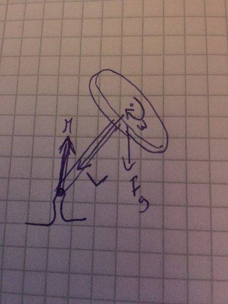

I was thinking something like this when the wheel is spinning clockwise and angular momentum is "inwards". Is this way of thinking wrong and how so?

Abokoj said:
So I've just started reading into how gyroscopes work and I've hit a wall. Previously I thought that the upwards angular momentum kept the spinning object up straight, but why does it do the same if it's spinning clockwise too even though the angular momentum would be pointing down? Does the angular momentum vector not have anything to do with it in the first place?
Even when you spin it clockwise and the precession becomes also clockwise the gyroscope will eventually straighteb up even when the angular momentum is pointing down for the precession too.
It feels like my understanding of the topic is not accurate. I'd appreciate some clarification, thanks.
"Upwards angular momentum kept the spinning object up straight"
No. Absolute not. That is just completely wrong. I am Just trying to be clear here. :smile:
Ok now my main point:
There are two motions occurring: the precession motion and the spinning motion. If we look at the spinning disk, we can point at its lower side and its upper side. The two motions are interfering constructively at the lower side, and destructively at the upper side.
If both of the two motions were reversed, the sides would stay the same, and the gyro's ability to stay upright would stay the same.
When I say "the two motions are interfering constructively at the lower side" I mean the atoms of the disk have the highest speed at the lower side of the disk.

Thanks for the help. So how does it work when the spinning top is spinning while standing ip straight. There wouldn't be any lower or upper side, are you saying that angular momentum does keep it up but not in a vector kind of way?
I think that was the one @A.T. It shows what is happening, starting with the simple example of a single satellite. The vectors help you do the math, but it really helps to intuitively understand what is happening.
In that case there just is no torque trying to make the top fall, and no torque trying to keep the top up straight, so the top stays up straight. I mean if the top really is in perfect balance, not leaning at all.
I recommend thinking about a top that leans a lot and precesses in a large circle. I recommend thinking the circling motion causing a centrifugal force on the disk, and the spinning of the disk increasing the centrifugal force on one side of the disk, and reducing the centrifugal force on the other side.
