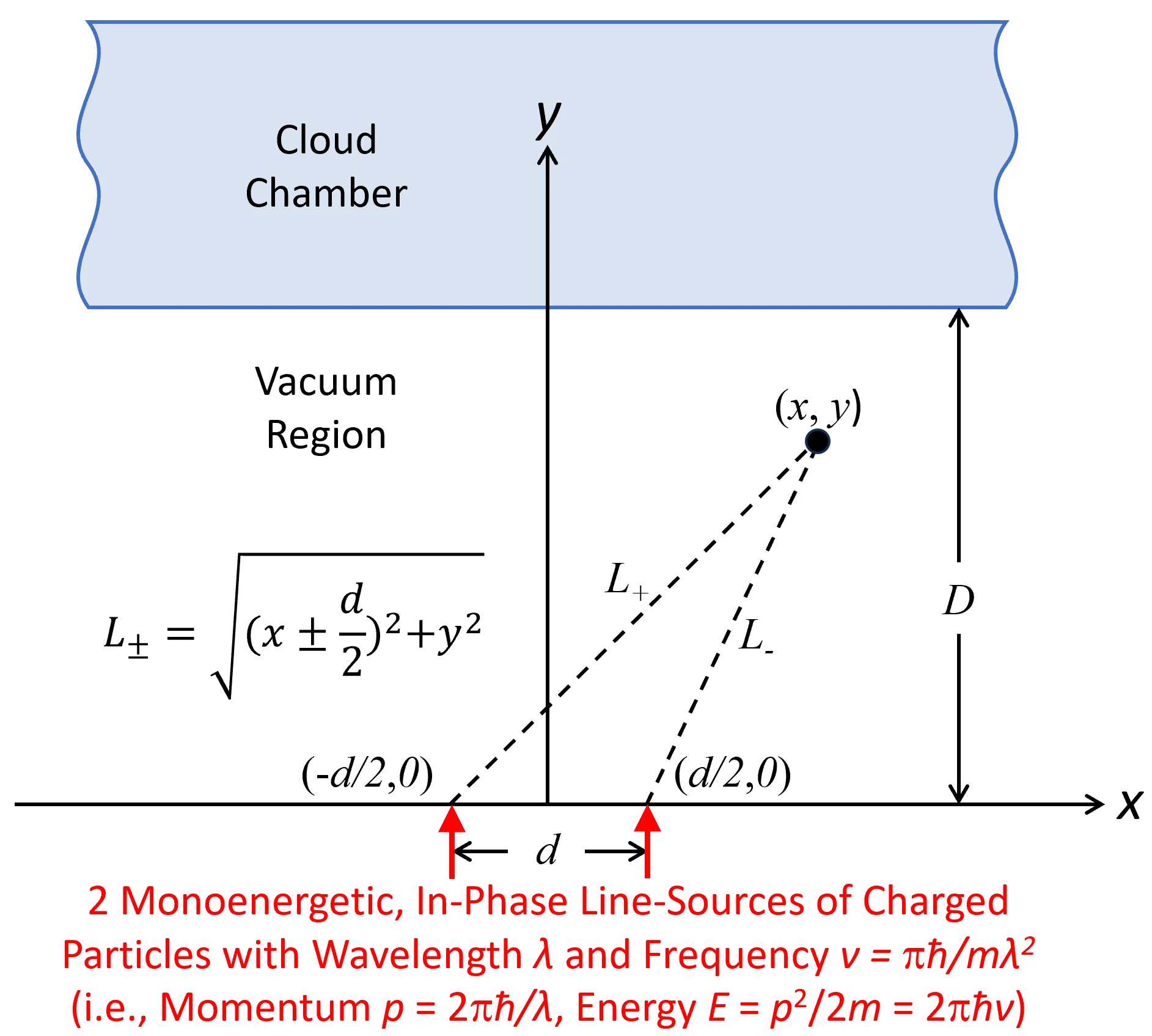

With this preamble out of the way, it's time to "just shut up and calculate" the flux ##\vec{J}\,## incident on a cloud chamber from 2 slits. Given the following (idealized) configuration:
the physical solution of eq.(1) is expressed in terms of the Hankel function ##H_{0}^{\left(1\right)}##:$$\psi\left(x,y,t\right)=Ne^{-2\pi i\nu t}\left(H_{0}^{\left(1\right)}\left(2\pi L_{+}/\lambda\right)+H_{0}^{\left(1\right)}\left(2\pi L_{-}/\lambda\right)\right)\tag{3}$$where ##N## is an arbitrary normalization constant. This solution is singled out because the two terms in (3) embody the required outgoing cylindrical waves, each propagating away from the ##z##-directed line-sources located at ##\left(\mp d/2,0\right)##, that ultimately impinge on the cloud chamber. (I use line-sources to avoid the inessential complication of finite slit-widths.) Since ##N## is arbitrary, I choose it to set the normalized wave function ##\psi_N## to unity "on-axis" at the entrance to the chamber; i.e., ##\psi_N\left(0,D\right)=1##. I can also drop the time-harmonic term ##e^{-2\pi i\nu t}## since it disappears from ##\rho## and ##\vec{J}##. Here is the resulting wave function:$$\psi_{N}\left(x,y\right)=\frac{H_{0}^{\left(1\right)}\left(\pi\sqrt{\left(d+2x\right)^{2}+4y^{2}}/\lambda\right)+H_{0}^{\left(1\right)}\left(\pi\sqrt{\left(d-2x\right)^{2}+4y^{2}}/\lambda\right)}{2H_{0}^{\left(1\right)}\left(\pi\sqrt{d^{2}+4D^{2}}/\lambda\right)}\tag{4}$$along with its gradient:$$\begin{align}&\nabla\psi_{N}\left(x,y\right) =\nonumber \\ & -\frac{\pi}{\lambda}\left(\frac{\left(d+2x\right)H_{1}^{\left(1\right)}\left(\pi\sqrt{\left(d+2x\right)^{2}+4y^{2}}/\lambda\right)}{H_{0}^{\left(1\right)}\left(\pi\sqrt{d^{2}+4D^{2}}/\lambda\right)\sqrt{\left(d+2x\right)^{2}+4y^{2}}}-\frac{\left(d-2x\right)H_{1}^{\left(1\right)}\left(\pi\sqrt{\left(d-2x\right)^{2}+4y^{2}}/\lambda\right)}{H_{0}^{\left(1\right)}\left(\pi\sqrt{d^{2}+4D^{2}}/\lambda\right)\sqrt{\left(d-2x\right)^{2}+4y^{2}}}\right)\hat{x} \nonumber \\ & -\frac{2\pi}{\lambda}\left(\frac{y\,H_{1}^{\left(1\right)}\left(\pi\sqrt{\left(d+2x\right)^{2}+4y^{2}}/\lambda\right)}{H_{0}^{\left(1\right)}\left(\pi\sqrt{d^{2}+4D^{2}}/\lambda\right)\sqrt{\left(d+2x\right)^{2}+4y^{2}}}+\frac{y\,H_{1}^{\left(1\right)}\left(\pi\sqrt{\left(d-2x\right)^{2}+4y^{2}}/\lambda\right)}{H_{0}^{\left(1\right)}\left(\pi\sqrt{d^{2}+4D^{2}}/\lambda\right)\sqrt{\left(d-2x\right)^{2}+4y^{2}}}\right)\hat{y} \nonumber \tag{5}\end{align}$$Equations (4) and (5) are the ingredients I add to (2a,b) to create the density fields ##\rho\left(x,y\right),\vec{J}\left(x,y\right)##, but I won't burden the reader by explicitly displaying their cumbersome analytical forms. It suffices to simply let my Mathematica software deal with the algebra and focus on visualizing the results.

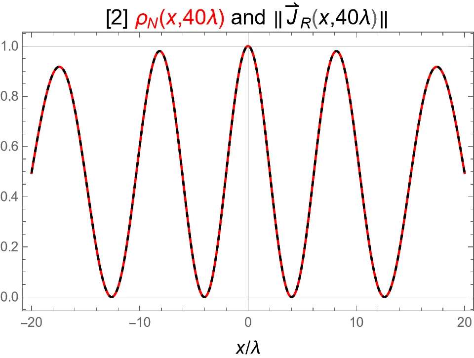

Plot [1] clearly exhibits the interference bands in ##\rho_N## characteristic of the 2-slit configuration, as well as the size and direction of the outflowing probability-flux vectors ##\vec{J_R}##. Note that those vectors (mostly) follow the interference bands and are longer at the blue-white peaks and shorter near the pure-blue valleys of ##\rho_N##. Indeed, plot [2] shows the distributions of ##\rho_N## and ##\Vert\vec{J_R}\Vert## to be virtually identical at the entrance to the cloud chamber, where they differ at most by a few parts in ##10^{-4}##, implying that the track-density in the chamber displays the same band structure as the spot-density on the target of the standard 2-slit experiment.

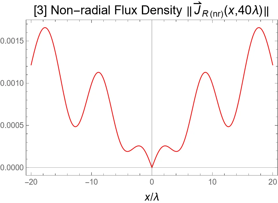

Beyond the "near-field" region in plot [1], the flux vectors primarily follow flow lines that more or less point back toward the origin, half-way between the slits. But on close inspection, it's also evident that a few short vectors in the nulls of ##\rho_N## are clearly non-parallel to the overall flow direction; moreover, some of the flow lines apparently "swerve" through a null before resuming their original direction. To investigate this "non-radial" behavior, I use the unit-vector ##\hat{r}\equiv\left(x\hat{x}+y\hat{y}\right)/\sqrt{x^{2}+y^{2}}## to decompose the total flux vector into radial (r) and non-radial (nr) components:$$\vec{J}_{R\left(\text{r}\right)}=\left(\hat{r}\cdot\vec{J}_{R}\right)\hat{r}\;,\quad\vec{J}_{R\left(\text{nr}\right)}=\vec{J}_{R}-\left(\hat{r}\cdot\vec{J}_{R}\right)\hat{r}\tag{6a,b}$$from which it follows that the magnitude of the non-radial flux density at any point is:$$\Vert\vec{J}_{R\left(\text{nr}\right)}\left(x,y\right)\Vert=\Vert\vec{J}_{R}\left(x,y\right)\Vert\sqrt{1-\left(\hat{r}\left(x,y\right)\cdot\hat{J}_{R}\left(x,y\right)\right)^{2}}\tag{7}$$and the angle of deviation of the non-radial flux density from the radial "boresight" direction is:$$\delta_{\left(\text{nr}\right)}\left(x,y\right)=\cos^{-1}\left(\hat{r}\left(x,y\right)\cdot\hat{J}_{R}\left(x,y\right)\right)\tag{8}$$Below are plots of these two quantities evaluated at the entrance to the cloud chamber:
Observe in plot [3] that the non-radial flux density is everywhere merely a tiny fraction of the total flux density. This minuteness is reflected in the expectation value of the total non-radial flux:$$\left\langle \Vert\vec{J}_{R\left(\text{nr}\right)}\Vert\right\rangle =\frac{\intop_{-20\lambda}^{20\lambda}dx\,\Vert\vec{J}_{R}\left(x,40\lambda\right)\Vert\sqrt{1-\left(\hat{r}\left(x,40\lambda\right)\cdot\hat{J}_{R}\left(x,40\lambda\right)\right)^{2}}}{\intop_{-20\lambda}^{20\lambda}dx\,\Vert\vec{J}_{R}\left(x,40\lambda\right)\Vert}=0.00151\approx\frac{1}{661}\tag{9}$$So out of every ##661## chamber tracks, all but ##1## are expected to point directly back to the center between the slits. And just how misaligned is that one exceptional track apt to be? Per plot [4], the deviation angle ##\delta_\text{(nr)}## can be as high as ##87°##, but that's only in narrow bands at the minima of ##\rho_N## where the probability of finding the particle is very low. Elsewhere, the deviation is essentially zero. In fact, the overall expected value of the deviation is just:$$\left\langle \delta_{\left(\text{nr}\right)}\right\rangle =\frac{\intop_{-20\lambda}^{20\lambda}dx\,\Vert\vec{J}_{R}\left(x,40\lambda\right)\Vert\cos^{-1}\left(\hat{r}\left(x,40\lambda\right)\cdot\hat{J}_{R}\left(x,40\lambda\right)\right)}{\intop_{-20\lambda}^{20\lambda}dx\,\Vert\vec{J}_{R}\left(x,40\lambda\right)\Vert}=0.0869°\tag{10}$$ Non-radial tracks are therefore fairly rare and most often only very-slightly misaligned. But that's not to say that tracks with larger deviations don't occur with lower probabilities. For example, the probability ##P\left(\delta_{\left(\text{nr}\right)}\geq5{^\circ}\right)## is ##2.78\times 10^{-5}##; i.e., the observed deviation angle equals or exceeds ##5{^\circ}## about once in every ##36,000## tracks.

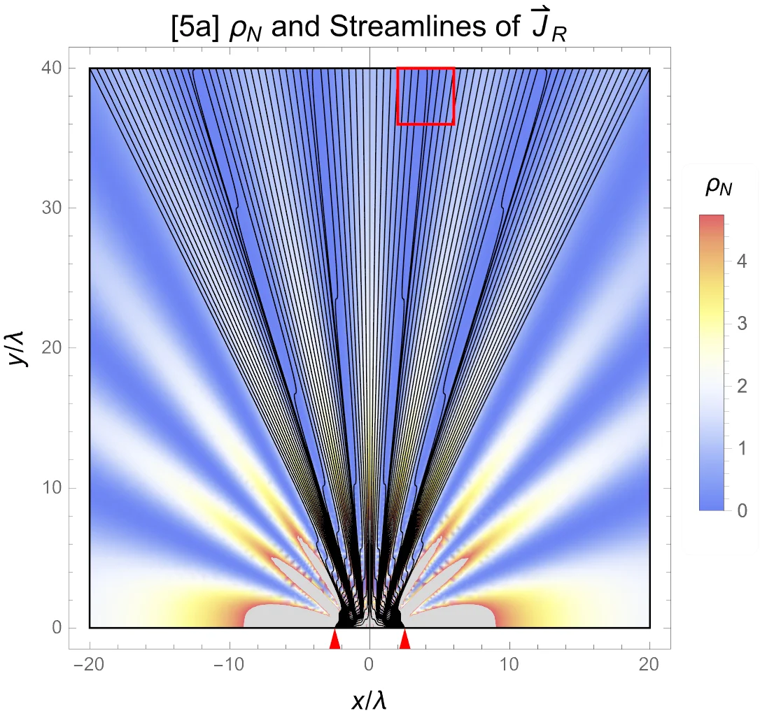

A more refined view of the current flow is available by plotting the streamlines (integral curves) of the ##\vec{J_R}##-vector field:

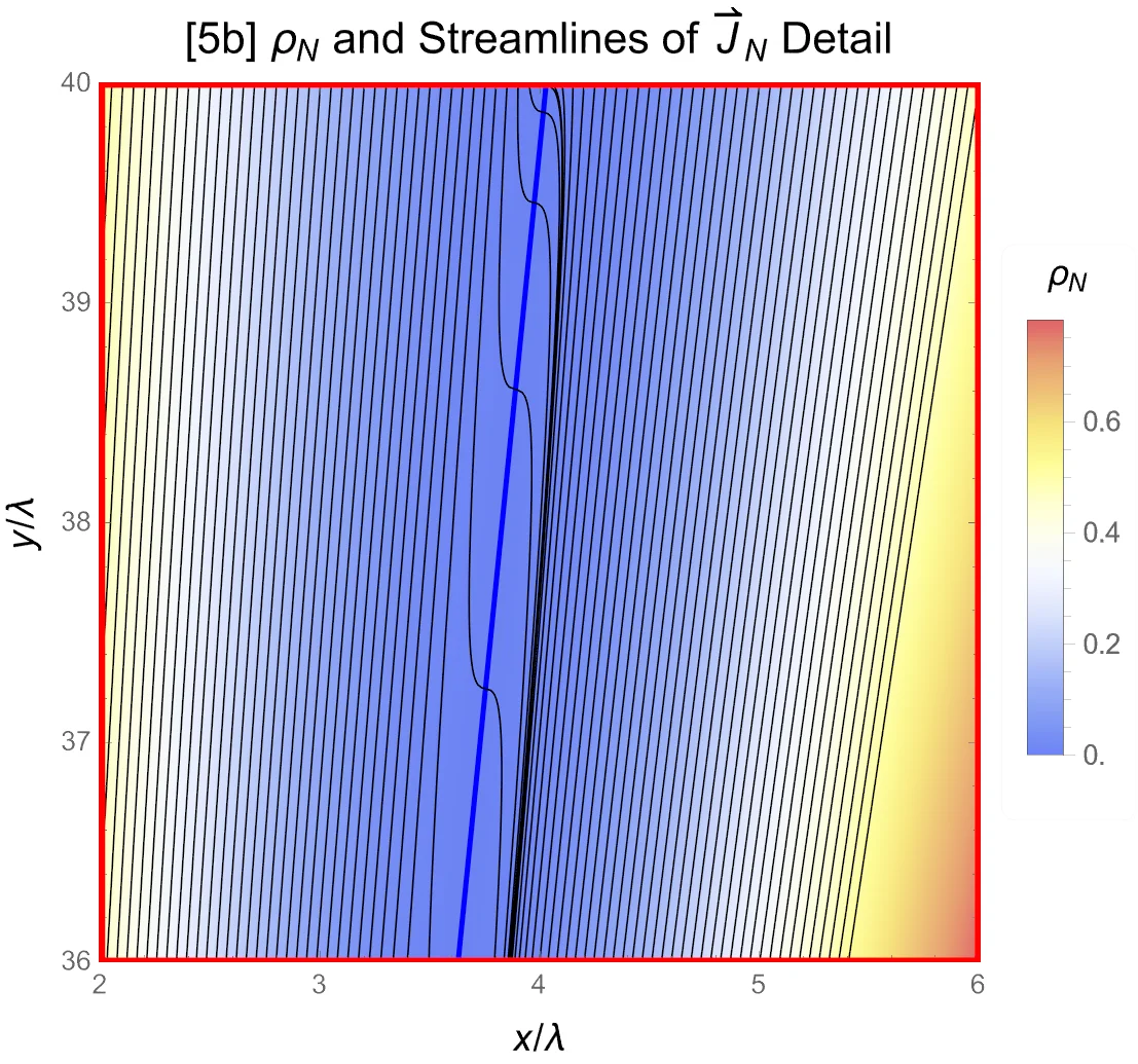

It's evident in [5a] that the current streamlines bend as they pass near to and cross through a null "valley" of the probability density ##\rho_N##, and then resume their radial path on the opposite side of that valley. This is especially clear in the magnified view [5b] where I explicitly demark the minimum of ##\rho_N## by the deep-blue line. I conclude that the direction of the streamline tangent-vector ##\hat{J}_R## swings dramatically during these crossing transitions, and whenever such a swing occurs near the entrance to the cloud chamber, the resulting track will be non-radial.

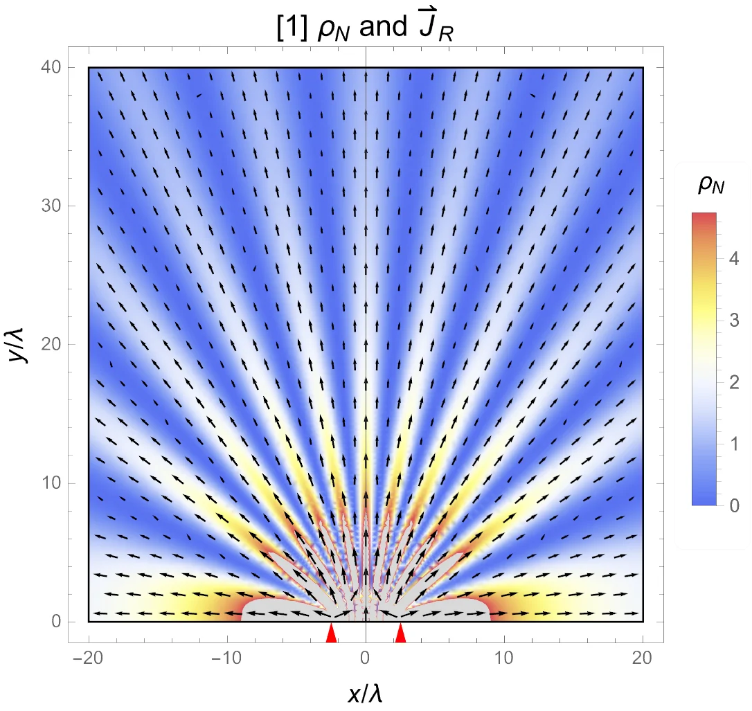

The Flux Direction

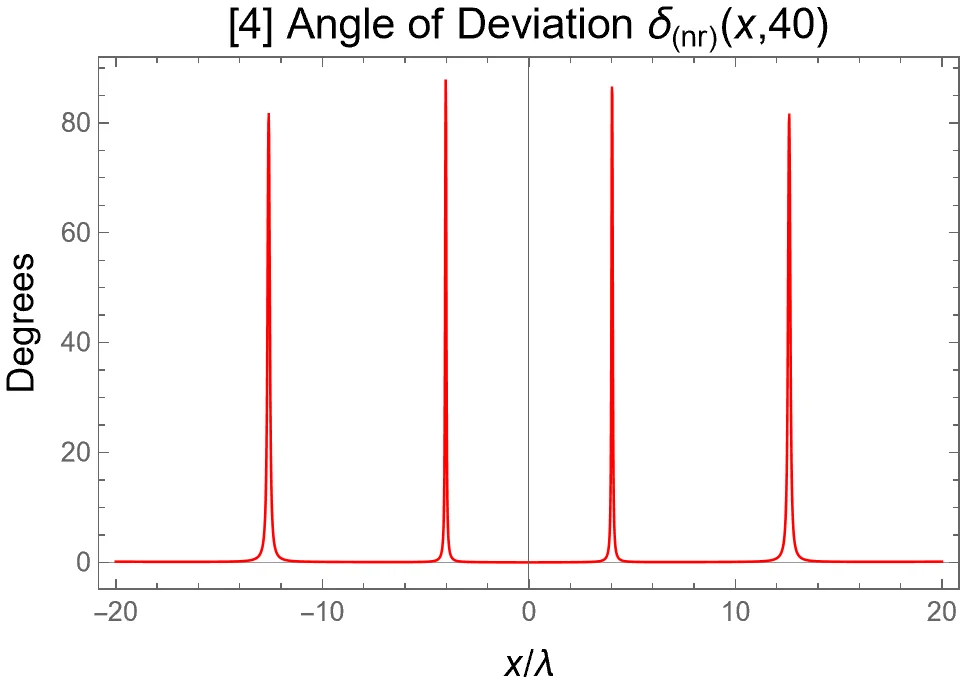

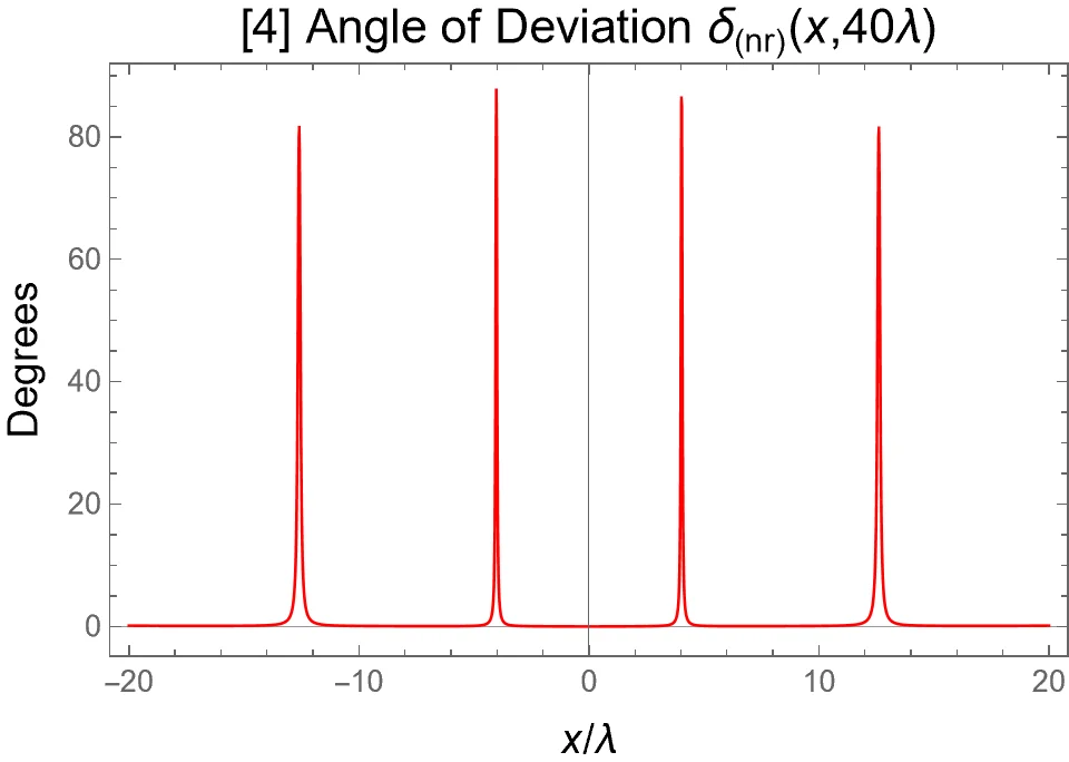

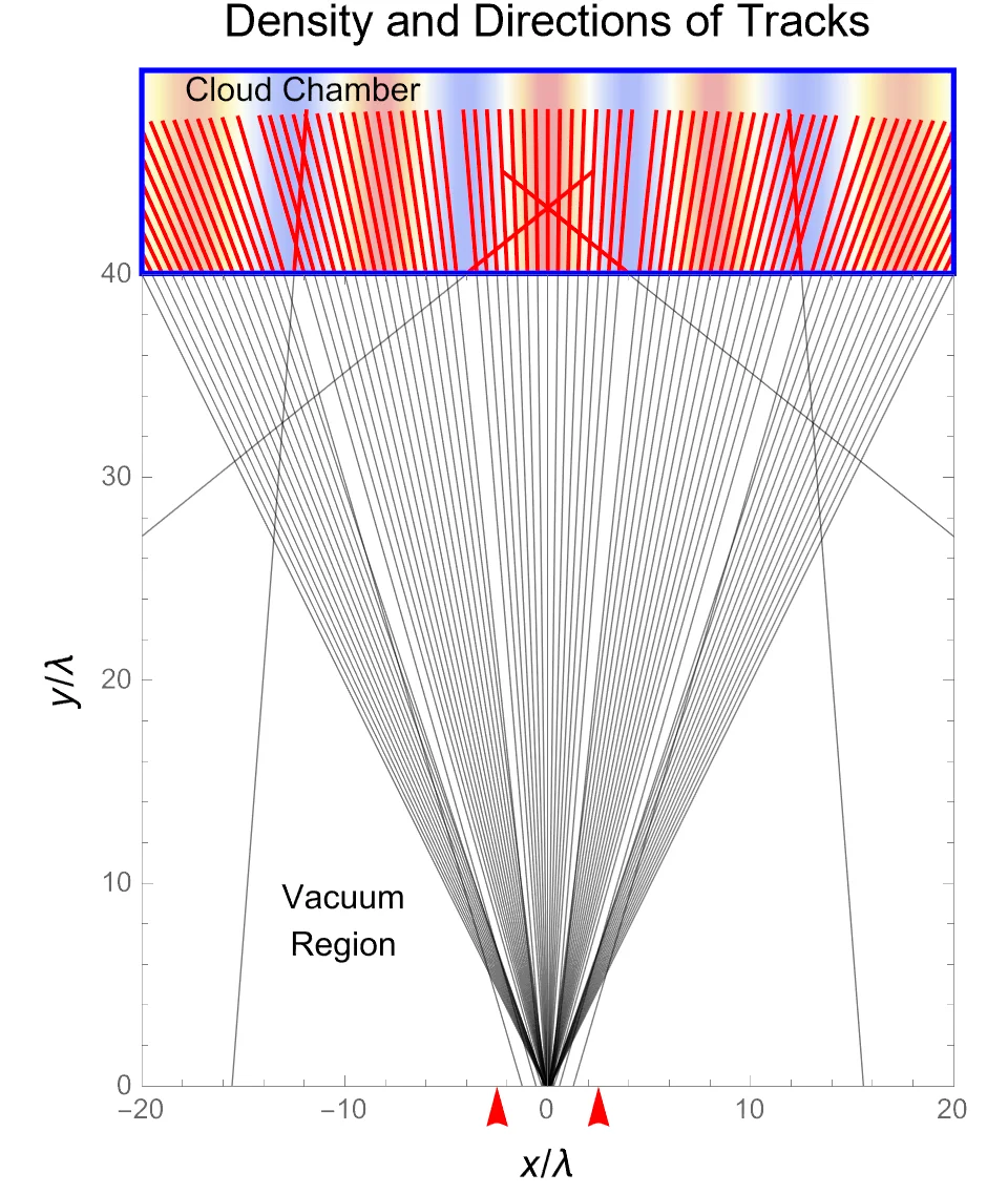

Below is a schematic representation of the cloud chamber tracks, their bands of varying density, and the locations from which they appear to originate:
I draw these final conclusions:
- All the chamber tracks have the same length (by virtue of the particles being monoenergetic).
- The track density varies in exact accordance with the standard 2-slit interference pattern.
- The tracks overwhelmingly backtrack to an origin point centered between the slits.
- But there are occasional tracks that emerge, with low probability, from near the interference nulls at angles that point back to "off-center" locations, sometimes markedly so.
