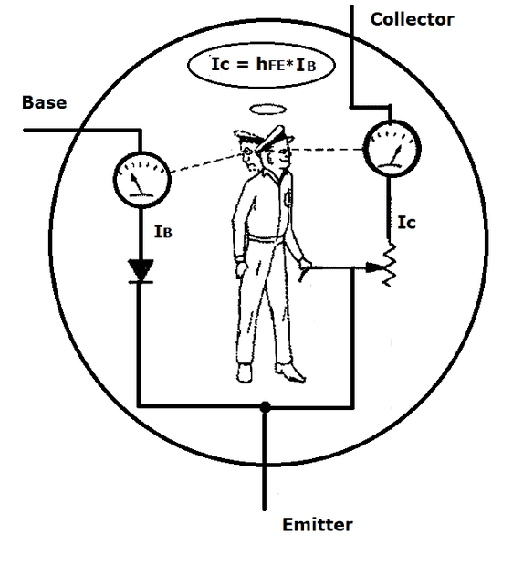

I was reading about transistors. There was one good video.. It said to treat the NPN transistor as two diodes.
And so I did. I remember learning that a forward biased diode can be treated as a cell that causes a potential drop equal to the barrier potential (while a reverse biased diode is an open circuit?)
But I don't know how to proceed further?
And the video explained how the current is amplified a little too fast towards the end. I didn't understand it. From the circuit diagram and the explanation in the video I can somewhat see that the current will be increased. But I don't understand how? And definitely don't see how it increases by multiplication instead of addition?(Like why is the collector current something times the base current and not something plus the base current?)

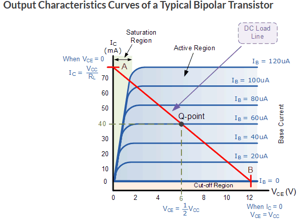

For me, one of the best images to keep in mind when thinking about how an NPN bipolar transistor works in the "Common Emitter" current amplifying configuration is using this graph:
https://www.electronics-tutorials.ws/transistor/tran_2.html
That is also a good tutorial to read through to understand why that plot is so instructive.
