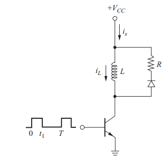

An inductor is energized as in the circuit shown in fig. The circuit has L =100 mH, R= 20 ohm, VCC= 90 V, t1= 4 ms, and T= 40 ms. Assuming the transistor and diode are ideal, determine (a) the peak energy stored in the inductor, (b) the energy absorbed by the resistor in each switching period, and (c) the average power supplied by the source. (d) If the resistor is changed to 40 ohm, what is the average power supplied by the source?
P = V*I Watts; V_L = Ldi/dt
The figure is as shown below

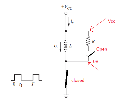

a. From 0< t < t1 => 0 <t<4ms, the transistor is "ON"
The circuit will become like this
The current ##i_s = i_L##. To know the magnitude of the current ##i_L## do i need to know the impedance of the inductance or since it is DC voltage the impedance is not applicable? The energy stored will then be ##E=\frac{LI^2} 2##.

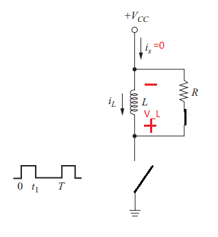

The circuit during t1<t < T => 4<t<40ms will be
There is a voltage ##V_L## developed across the inductor because of the previous cycle and hence it forward biases the diode. There is no current flow through the source as the transistor is off. The inductor discharges through the resistor. My problem is how to use the equations and find the voltages and currents. Please help.
I think you have analyzed it correctly. For your first question when the switch is closed, you absolutely need to take into account the inductive reactance of the inductor, otherwise the current would be infinite since an ideal inductor has no resistance. Can you write a differential equation for the current I in this case? You should know the equation for the current through an inductor. Similarly, you need to write a differential equation for the current I in the second case when the switch is open.

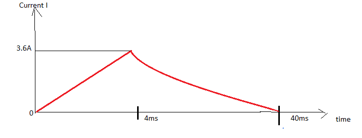

Yes i understood the mistake with the constant of integration, the current will look something like this.
The constant of integration is
##\ln(i_L) = \frac{-Rt} {L} + C## ->eq31
if t = 4ms ##i_L=3.6A## substitute in eq31
##\ln(3.6) = \frac{-20*4*10^{-3}} {0.1} + C##
##1.28 = -0.8 + C => C = 2.08##
Hence ##i_L = e^{-200t + 2}##
The energy
##E = \int_{4*10^{-3}}^{40*10^{-3}} e^{-400t+4} * 20 dt ##
##E = \frac{20} {-400}[e^{-400t + 4}]_{4*10^{-3}}^{40*10^{-3}} ##
##E = 0.551 J ##. I don't know how to cross check.

@PhysicsTest I think your graph is qualitatively correct, except it discharges much faster than what you have shown. As @Steve4Physics has said, basically all of the energy stored in the inductor gets dissipated in the resistor each cycle. In terms of the average, remember that you were asked for the average power, not the average energy.
