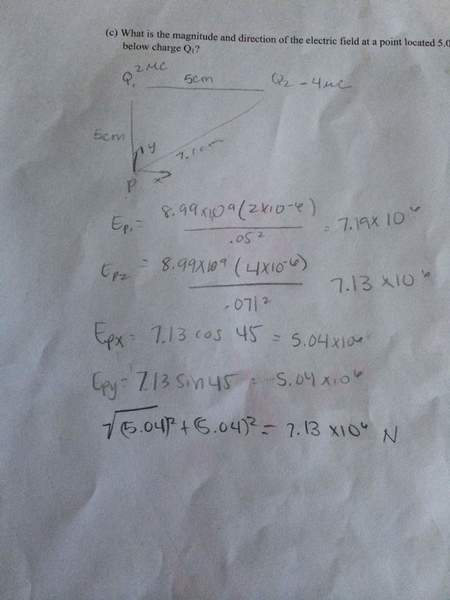

q1= 2microC and q2=-4microC they are on a straight line 5.0 cm away from each other.
a)find the magnitude of the net force on charge q2 due to q1
b) in what direction will the net force acting on charge q2 due to q1 be directed
c)what is the magnitude and direction of the electric field at a point located 5 cm directly below charge q1
d)what is the magnitude of the electric potential located 5 cm directly below charge q1
I'm confused on what to do for only two points. Any help is appreciated and please explain so I can try to get an understanding
for A) i got 28.8 N and B) the forces will attract. not sure if those are correct

This is what I came up with, it doesn't seem correct to me, but I'm not sure where I went wrong
You need to sum the components of the electric field of ##\vec E_1## and ##\vec E_2##.
What about the direction? Draw ##\vec E_{net_x}## and ##\vec E_{net_y}## head to tail and apply ##tan(\theta) = \frac{E_{net_y}}{E_{net_x}}##.
d) Same deal as c) pretty much, except potential is used instead of the electric field.
