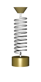

Hi guys. It could be an easy question but I started at the deepest. I wonder how it works like a car suspension system. How does damper work with spring? What is the difference between forced-nonforced systems? Why do we calculate frequency of spring? What does it provide us? What is the point at writing motion equation? I need backup a little bit. I already thank you.

One fascinating thing about a forced system, is that if you set the force at a certain frequency (like pushing a kid on a swing), you can observe that the motion amplitude will increase under that force, sometime until the spring breaks. We call this frequency the resonance frequency of the system (not just the spring).
Why do we care? Here is the typical example to demonstrate what can happen under this phenomena (the bridge's own weight represents the mass, its structure represents the spring stiffness plus some damping and a small wind creating turbulences under and over the bridge at the critical frequency is the force «gently» pushing the bridge):
So now the questions are «Why?», «How do we identify this frequency?» and «How can we attenuate the phenomena?» The answer lies in the equations of motion, hence their importance.
The damper provides the force that goes against the motion and can thus attenuate the amplification and slows down the motion until the mass goes to rest (without damping, the motion never stops, like in the previous animation).
