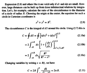

Please click the attached image.
I have no idea how eq 20.10b to eq 20.10c.
Hartle goes from the equation for the arc length to [tex]\sqrt{\frac{R^2}{R^2-x^2}}[/tex]

compute dy/dx and plug into 2.10.b. It leads directly to 2.10c. I certainly couldn't see it by eye - but it is a pretty small calculation.

Sorry, I'm not able to read between the line here. What do you mean by compute dy/dx? Compute dy/dx of what?
You have x^2+y^2=R^2. Solve for y and take dy/dx. Plug this into where dy/dx is in 2.10.b. You can then simplify to 2.10.c.

One more question, do you know how he got -1, 1 as the limits of integration? It looks as if he pulled that number randomly.

A change of integration variable was made such that the new integration variable is dimensionless, i.e., [itex]\xi = x/R[/itex].

Okay, I also don't know how that integral will give you Pi. Something is missing in my knowledge-base.

That integral should be covered in any first course in calculus; or looked up in even the smallest table of integrals; or recognize that it is the circumference of a unit semi-circle. If you're reading this book, you should have calculus book, and can review integration of trigonometric forms.

Thank you, I should have realized that. What I also should have done is just evaluated the integral to see that it equals pi.
