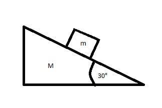

A wedge of mass M rests on a horizontal table. A block of mass m rests on the wedge.
http://imgur.com/cS02MvM
(a) What horizontal acceleration, a, must M have relative to the table to keep the block stationary relative to the wedge, assuming no friction?
(b) What horizontal force F must be applied to the system to achieve this result, assuming a frictionless table top?

All I have so far is this diagram as I don't understand the concept involved. Its not clear to me why the horizontal acceleration of the wedge could keep the block stationary. Also, I'm not sure whether this acceleration would be to the left or to the right.
Also I have read through other similar threads but still can not understand the problem.

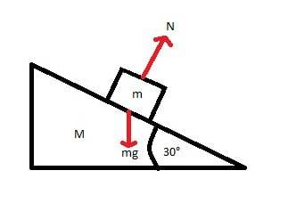

Start by writing the FBD equations. Note that for mass m to be stationary with respect to the wedge, its vertical acceleration must be zero, and it horizontal acceleration must be equal to that of M.

Here's what I got:
Ncos30° = mg
Nsin30° = F = (m+M)a
Is this right?

Here's what I got:
Ncos30° = mg
Is this right?
The first equation, yes. But is F above the force applied to the wedge, as in the question? Why would that be equal to N sin 30? What body did you study an FBD of to obtain it?

Yes, F is the force applied to the wedge.
I realize F is not equal to Nsin30° now. The horizontal force acting on the block is Nsin30°. The horiztonal force acting on the wedge is F.
As voko said, the horizontal acceleration of the block must be equal to the horizontal acceleration of the wedge. So, since acceleration is force divided by mass I get this:
(Nsin30°)/m = F/(m+M)

Using the two equations:
Ncos30° = mg
I was able to rearrange to get the following:
F/(m+M) = gtan30°
a = gtan30°
F = (m+M)gtan30°

Looks good.
