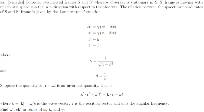

Physics problem statement with Lorentz transformation equations for ct', x', y', z' in terms of ct and x, gamma = 1/sqrt(1 - beta^2), beta = v/c, and the invariance condition k' dot r' - omega' t' = k dot r - omega t, asking for omega' and ck' in terms of omega, k and gamma.
ok so for w' i am getting since the s' is only moving in x direction
\omega' = \omega \gamma (1 + \beta)
is this correct then i am having some trouble in dealing with the dot product to derive for
\bf {ck'}

Orodruin said:
It is not generally correct. Please show your work.

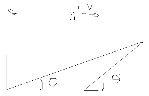

oh are you saying the event can occur above or below the x axis
ok then letting the event be anywhere on the xy plane then
let v be the relative velocity between s' and s
and ##\theta## be angle formed in s and ##\theta'## the angle formed in s'
f be the frequency in s and f' be the frequency in s'
Hand-drawn diagram of two frames labeled S and S' with S' moving right at velocity V; a line from each origin points to a common event, marked with angle theta in S and theta prime in S'.
then
f = f_0\\
f' = f_0 \frac{\sqrt{1 - \frac{v^2}{c^2}}}{1 - \beta cos \theta'}
is this correct?

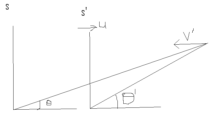

  • Hand-drawn diagram of two frames S and S' with S' moving right at velocity u; a ray from a source at the lower left of S and a ray in S' are drawn to a point at right, with angles theta and theta' marked at their origins and velocity v' arrow pointing left.
  • Hand-drawn diagram of two frames S and S' with S' moving right at speed u; a light ray travels from the origin of S to a point at right, with angle theta in S, and a second ray with angle theta' in S' with a velocity v' arrow.
  • Hand-drawn diagram of two frames labeled S and S' with S' moving right at velocity V; a line from each origin points to a common event, marked with angle theta in S and theta prime in S'.
You are seriously overcomplicating things. All that is asked is how ##\omega'## and ##\vec k'## needs to be expressed in terms of ##\omega## and ##\vec k## for the expression ##\vec k \cdot \vec r - \omega t = \vec k' \cdot \vec r' - \omega' t'## to hold. You just need to make sure that this holds regardless of the values of ##t## and ##\vec x##.
