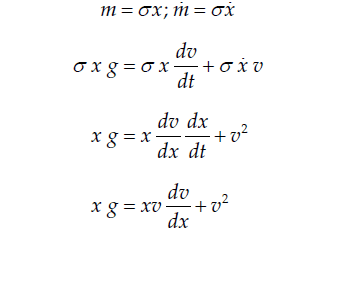

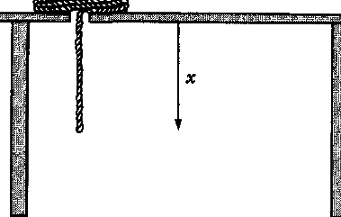

From (Marion 5th ed. Problem 9-15)
A smooth rope is placed above a hole in a table. One end of the rope falls through the hole at t = 0, pulling steadily on the remainder of the rope. Find the velocity and acceleration of the rope as a function of the distance to the end of the rope x.
Ignore all friction. The total length of the rope is L.
I attempt to solve it by lagrangian L = T - U
T = 1/2 (λx) v^2
U = -(λx)g(x/2)
where λ is mass density
But someone said it is not correct. He claimed that if T depends on generalized coordinate explicitly(in this case x), then it violates Newton's Second Law.
So, lagrangian mechanics cannot be used in open system ?
Marion's Solution
F = dp/dt = m(dv/dt) + v(dm/dt) (see Fig)
I learned that we cannot differentiate m (i.e. dm/dt) if the system is open.
So, which one is correct ??
Can anyone explain to me in detail ?

I don't see what's wrong with the given Lagrangian. The Euler-Lagrange equation give the same equations of motion as given in the book.

Bad news. The solution in Merion is incorrect. The entire rope is accelerating, and not just the part that has passed through the hole. This needs to be taken into account. Let F be the tension in the rope at the hole. Then the force balance on the part of the rope below the hole at any time is:
[tex]σgx-F=\frac{d(σxv)}{dt}[/tex]
The force balance on the part of the rope above the hole is:
[tex]F=\frac{d(σ(L-x)v)}{dt}[/tex]
If we add these two equations to eliminate F, we get:
[tex]gx=L\frac{dv}{dt}[/tex]
Well, then I misunderstood the drawing. I thought the rope is curled up on the table and thus only the part gone through the hole is accelerating. If you have the other case, of course you get another equation of motion.

No, it's not. The rope is coiled just above the hole. The only part of the rope that is accelerating is the part that is falling.
Your understanding is correct. The rope is coiled up just above the hole so that the only part that is accelerating is the part of the rope that has already passed through the hole.
Even if it's coiled, part of it is still accelerating, although not nearly as much as if it is straight. But, actually, I didn't notice that it was coiled.
Ah, okay. I think the intent of the problem is that the rope on the table remains at rest, and only a small piece of length v dt is accelerated from rest to speed v at time t.

Indeed, now that I checked the problem more carefully, I also see that this can not be treated via the Lagrange formalism. The reason seems to be that in the motion always new material of the rope is added to the moving part and thus that we have not a closed system.
The correct way is to use Newton's 2nd Law directly:
[tex]\mathrm{d}_t p=m g \; \Rightarrow \; x \ddot{x}+\dot{x}^2=m g.[/tex]

This problem can be solved without resorting to variable mass. Look at what is happening to the rope as a whole. Since the rope's mass isn't changing, it is perfectly safe to use Fext=dP/dt. What is the net external force on the rope? What is the rope's total momentum, and what is it's time derivative?
But not the whole rope is moving, i.e., not the total mass is to be put into the momentum. I try to get the equation right, again: The moving mass is [itex]m=\lambda x[/itex] and thus
[tex]\lambda \frac{\mathrm{d}}{\mathrm{d} t} (x \dot{x})=\lambda x g \; \Rightarrow \; x \ddot{x}+\dot{x}^2=g x.[/tex]
This equation is correct, because the material entering the motion is at rest before and thus carries no momentum.
