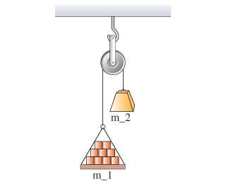

Atwood's Machine. A load of bricks with mass m_1 = 15.0 kg hangs from one end of a rope that passes over a small, frictionless pulley. A counterweight of mass m_2 = 28.0 kg is suspended from the other end of the rope, as shown in the figure. The system is released from rest.
F=ma
I really don't know what to do for this one. So far, I just calculated the weight of each masses.
Mass 1 Weight = -147N (15)(-9.8)
Mass 2 Weight = -274.4N (28)(-9.8)
Sorry, I have a bad habit of not posting the questions now for some odd reason.
What is the magnitude of the upward acceleration of the load of bricks?
Take the free fall acceleration to be g = 9.80 m/s^2.
What is the tension in the rope while the load is moving?
The upward acceleration of the bricks will be the same as the downward acceleration of the counterweight. Seems to me that the difference between the two weights is important somehow.
For the tension in the rope, I would think the weights add.
