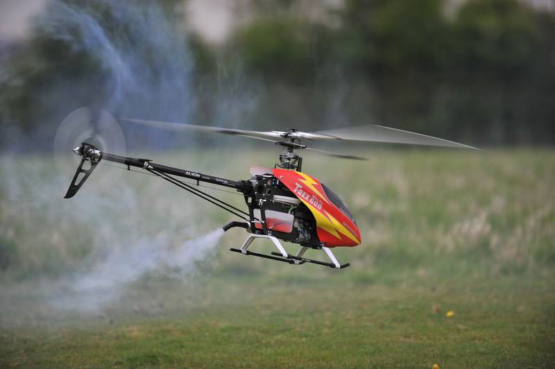

There are RC helicopters in classic setup:

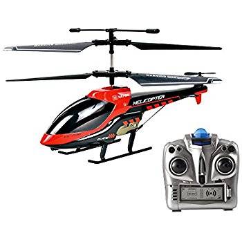

You can also find RC helicopters in coaxial setup. Especially in a cheapest, toy like models:

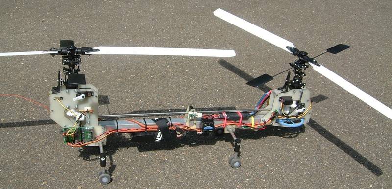

Here you can see tandem type RC helicopter:
I think it's just a matter of how complicated and expensive model is. Most RC models are cheap and mass produced and therefore Kamov-type coaxial rotors are simpliest to manufacture. They use small and weak engines which need to be in that setup to give a proper lift.
What model RC Chinook is shown in the picture? It looks like it has a fairly complicated rotor-head?
