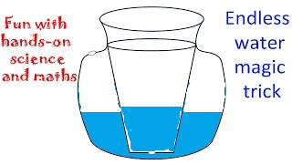

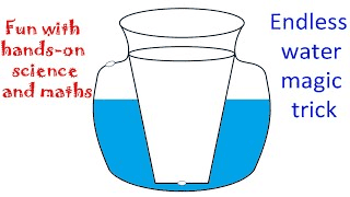

Xenon02
132
Hello!
Can anyone help me understand why this experience works this way?
If we plug the hole on the left side, the water does not affect the cup that has the hole on the bottom. However, if we let go of this hole on the left side, the water will start to pour into the cup again.
Is the law "Connected utensils" isn't implied here? Because normally the water should equal it's water level with the other connected vessels/cups.
I heard something about underpressure creating in the bottom hole but I don't understand it at all.
Could someone please explain me how does it work? I'm very curiouse how it works.
Thanks for reading this post.
As I understand the drawing, you have an empty transparent plastic cup seated in a fishbowl so that there is a tight seal between the lip of the cup and the sides of the opening into the bowl. The cup displaces some of the water in the bowl.
As a result, there is a sealed air space inside the bowl, outside the cup and above the water line.
We suppose that the cup has been inserted into the bowl prior to a hole being bored in its bottom. A hole is then bored in the bowl and pressure is allowed to equilibriate before that hole is sealed with a finger.
Now a hole is carefully bored in the bottom of the cup without unsealing the cup from the bowl or the finger from the hole in the bowl.
You begin by asking why water does not flow up into the cup through the hole in its bottom.
Answer:
If water did flow (and a small bit will actually do so) then the volume of the air space will increase and the air pressure in that space will decrease as a result.
That would be the "underpressure" explanation you have been given.
At the top of the water in the bowl, the water pressure there is equal to the air pressure in the sealed air space.
As you go deeper into the bowl, the water pressure increases with depth. The amount by which it increases is given by ##\rho g h## where ##\rho## is the density of the water (1 gram per cc) ##g## is the acceleration of gravity and h is the depth below the water's surface.
If the pressure deficit in the air space reaches ##\rho g h## for the ##h## = the depth of the hole in the cup then the pressure difference across the hole in the cup will be reduced to zero and no further water will flow.
Watch the video.

Xenon02 said:
##\dots## but I'm more interested in why doesn't the water go into the cup when the whole is sealed.
Because the hole is sealed. For water to go into the central cup from the side reservoir, air needs to come in and take its place. With the hole sealed this cannot happen.

Xenon02 said:
But if the we seal the bowl that already has the air. Can't the air spread in the place where water went to the another cup? The air will decrease in pressure but it can spread into the bigger vessels.
Pressure is what drives the water to flow. Decrease the pressure enough and it will not flow.
"Enough" turns out not to be very much: ##\rho g h##.
Back of the envelope... One atmosphere is 30 feet of water. If the water is one inch deep on the outside of the cup, that amounts to a pressure of 1/360 of an atmosphere. If water in the bowl drops far enough that the air space increases in volume by a factor of 0.3 percent, the water will stop flowing into the cup.

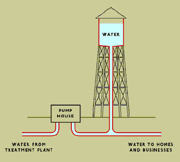

Does Water tower also requires air and water pressure to flow?
Xenon02 said:
That's how I insert pgh equation here? When the h = the depth of the cup it's normal that it won't pour anymore inside the cup but why the air is important in this equation? Because water pressure is exactly pgh and for the water to flow it needs it's pressure and why if air losses pressure not water but air then the water will not flow?
It is the pressure difference between two points in the water that is given by ##\Delta P=\rho g \Delta h##
If the pressure at the top of the water is less than atmospheric by ##\rho g h## then the pressure at depth ##h## will be exactly equal to atmospheric.
When water pressure at the hole in the cup is equal to atmospheric pressure at the hole in the cup, nothing flows through the hole.

Xenon02 said:
So when the water goes out of the vessel when it's sealed the air pressure reduces to pgh
No. It does not reduce to ##\rho g h##. It reduces by ##\rho g h##.
That means that its resulting pressure at the water surface becomes ambient minus ##\rho g h##.
That means that the pressure at depth ##h## below the surface then is equal to ambient.
At which point no fluid flows through the hole in the cup (at depth h below the surface) because the pressures on both sides are equal.
The pressure in the air space reduces to ##\rho g h## below ambient precisely because that is the pressure that results in no further water flow.
