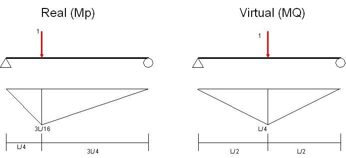

What I have done in the first image is drawn the beam and bending moment diagrams under one unit of load in both the real and virtual system (you might want to check the bmd's, it was a quick sketch).
In the real system, we are applying a load at L/4, but we want the deflection at L/2 so we apply a load of 1 unit in the virtual system.
So if l/4 is point B and L/2 is point A, then you will be trying to find fab. (That is, deflection at A due to load at B)

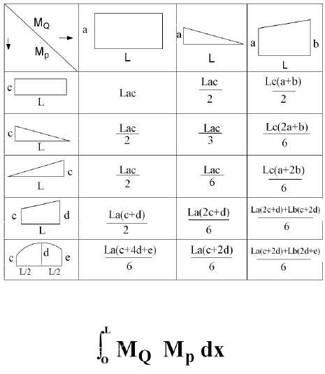

I have uploaded a table to help you with this. you can do it with integration which is essentially what the tables do, but since you have to break the intergral up into 3 segments you get a lot of ugly algerbra to deal with. Its not difficult maths, but it is very easy to make a mistake. You will still need to do the problem in 3 parts with the tables, but it should work out a bit easier/neater.
Once you get a value for fab, then useing the reciprical theorem you have also found fba. This implies that a the deflection at A due to a unit load at B is the same as the deflection at B due to a unit Load at A. fij=fji

Since you need to know the basic process for you assignment, here is how I solved for f_bb
draw the BMD's under a unit load(both virtual and Real)
>you will see they are identical
>each gBMD has to be broken up into 2 triangles
>use the sheet supplied to integrate the area of triangle #1 in the real with triangle #1 in the virtual
>do the same for the second triangle and sum the 2 values.
the sheet say the formuala for 2 triangles is [tex]\frac{LAC}{3}[/tex]
so, by applying this to both parts of the BMD (real and virtual)
we get
[tex]f_{bb}=\frac{1}{EI} \cdot (\frac{1}{3} \cdot \frac{L}{4} \cdot \frac{3L}{16} \cdot \frac{3L}{16}+\frac{1}{3} \cdot \frac{3L}{4} \cdot \frac{3L}{16} \cdot \frac{3L}{16})=\frac{3L^3}{256EI}[/tex]
Note: L in the equation is the segment of the beam you are considering, not the length of the beam itself. Also note how I have 2 parts in this equation, this is because I had to break the problem into 2 segments.
