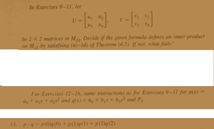

Textbook page showing exercise instructions: 2 x 2 matrices U and V in M22 with entries u1, u2, u3, u4 and v1, v2, v3, v4, and a polynomial exercise defining p(x) and q(x) in P2 with the dot product formula p·q = p(0)q(0) + p(1)q(1) + p(2)q(2).

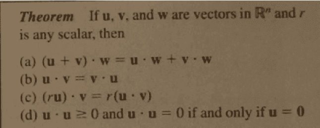

here is theorem 4.5
Printed theorem on vector dot product properties: for vectors u, v, w in R^n and scalar r, (a) (u + v)·w = u·w + v·w, (b) u·v = v·u, (c) (ru)·v = r(u·v), (d) u·u ≥ 0 and u·u = 0 if and only if u = 0.
How can theorem 4.5 even relate to the question? The question deals with p's and q's and the theorem deals with u v w.
The short version of what I said in the other thread is this:
The theorem deals with three arbitrary vectors that are elements of a given vector space. They do not need to be called u, v, and w.
well how do i even find out if
p(x) = a0 + a1x + a2x2
q(x) = b0 + b1x + b2x2 and P2
meets the condition (u+v) *w = u*w + v*w?
What's the first question I ask myself? I don't even know what step 1 is, much less 2 and 3
[itex]P_2[/itex] denotes the space of second-order polynomials. All you need to test this condition is to come up with a third "vector" (another second-order polynomial) that you can plug in as w.
This condition you're testing is the distributive property. It's the same thing as saying that (5+10)x6 = 5x6 + 10x6. I can plug in any three numbers there instead of 5, 10, and 6 and it works because the real line is a (very simple) vector space of sorts.
What you do to test this is simple. If I want to test the distributive property on real numbers, I go to what I just wrote and say, hm, is (5+10)x6 -> 15x6 really equal to 5x6 + 10x6?
At that point, you just evaluate both sides until you get something that's obviously (un)equal.
