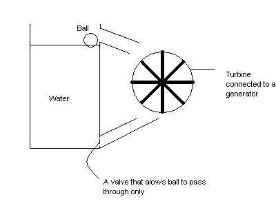

A system is developed as shown in the diagram attached. The ball is initially given a push so that it falls onto a turbine connected to generator which produces electricity. After rotating the turbine the ball fall down a narrow tube with a valve into the water again the ball rises again and is again given a slight push and the whole process is repeated again and again. In this way energy is being "created". The question is: How does this machine obeys the principle of conservation of energy?

Do you think it is possible to push the ball through the valve and into the water without doing any work?
No I dont. In my opinion the KE of the ball will be used to open the valve...
And, of course, the ball will have lost some of its energy in turning the turbine.
