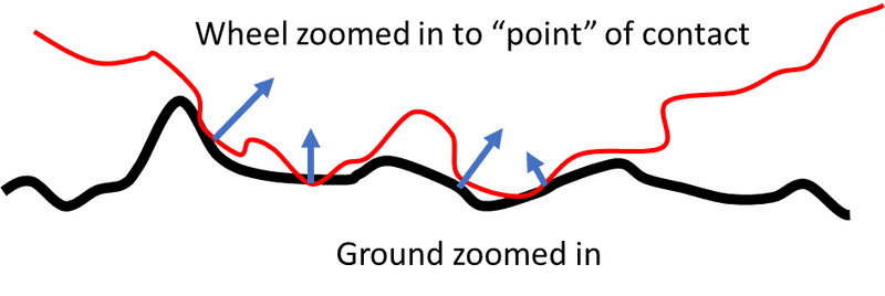

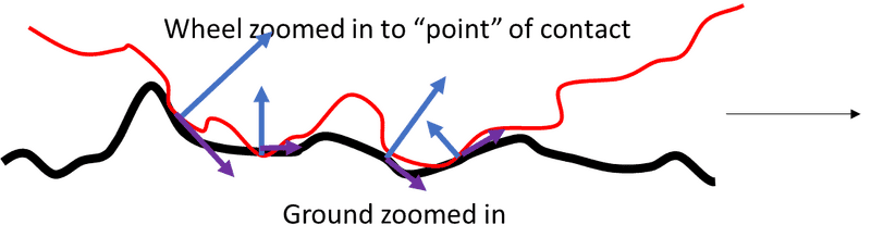

I think we should focus on center of mass work. Lets say we have zoomed into the point of contact:
Does the instantaneous center of zero velocity exist and is it on the meshing surfaces?
The blue vectors are "micro-Normals". Do we actually have that the effect of "static friction" is actually just the summation of the "micro Normals" in the parallel direction?
Are there also "micro kinetic frictional forces" at the all the points of contact, because they aren't actually at rest? They are plastically deforming each other, and exchanging mass etc... Add them to the summation?
Is this what "the effect" of static friction really is that we just "give up" and call ##f_s ##?
We should use whichever concept helps us deal with the problem at hand.
If one adopts center of mass work on the car then one does not notice that the drive wheels are rotating, the drive shaft is under torque and the engine is running. The source of the car's motion appears to be the asphalt. Which is true enough, as far as it goes.
For some problems, this might be the appropriate level of detail to use.
If one adopts mechanical work then one might choose to idealize the tires as having zero slip. This will not be exactly correct. We will miss the fact that the drive wheels are slipping slightly while accelerating. But for moderate load, such as on a dynamometer, this idealization will work fine.
Center of mass work would be utterly useless on a dynamometer, of course.
We might choose to acknowledge the existence of slip and quantify it in terms of percent slip versus applied force versus normal force. This would allow us to calculate how much engine power is wasted during acceleration and how much side slip should be expected on turns.
If a racing team is not down to at least this level of detail, they are not doing their jobs.
But I agree that no one wants to go down to the detail of micro-normal or micro-kinetic friction, even though that may well be a more precisely accurate model of what really goes on.
Yes. Static friction is an engineering approximation.

erobz said:
In my text by Giancoli there is a section "Why Does a Rolling Sphere Slow Down" conclusion "A rolling wheel does not slow down under the force of static friction" paraphrasing
One can regard the off-center normal force from the increased up-force on the front and the reduced up-force on the back as resulting in a torque on the rolling sphere. That torque retards the rotation of the sphere. As the sphere tends to slow in response to this torque, the result is a force of static friction between the sphere and the ground. A force of static friction that tends to slow the linear motion of the sphere.
We need not invoke microforces to understand this macroscopic behavior. It is enough to invoke hysteresis in the compression and rebound of the sphere's material. Or the material of the ground.
erobz said:
"A rolling wheel does not slow down under the force of static friction" paraphrasing*
Static friction doesn't dissipate energy into heat. But it might convert linear motion into rotation, and vice versa.
erobz said:
However, if we take a model for
that assumes these micro forces are underlying, it's an inevitability.
The above also applies to your micro normal forces.

I also think there are micro kinetic friction forces baked into static friction. When imagine that very zoomed in jagged wheel, it has a point of contact that is its instantaneous center of zero velocity for the "wheel". The other jagged surfaces that are in contact simultaneously are thus sliding past each other, because they are not actually on the instantaneous center.
So I think static friction, as we bake all of this microscopic stuff together to devine "##f_s##" does dissipate energy.
I understand that in perfect circle meets perfect line fantasy land ##f_s## wouldn't generate heat, but in that world a ball probably wouldn't even "roll" to begin with. Everything would just slide and rotate independently.
The idea of static friction surely demands this reality of imperfection to make sense.
I think you are talking about rolling resistance. Introducing it changes the simple model of rolling in which there is static friction ##f_s## (never mind how it arises) that adjusts itself to provide the observed acceleration. In this simple model, a ball rolling without slipping on a horizontal plane keeps on rolling along like ol' man river. It's a simplification used to introduce the main ideas behind rolling to physics students. Rolling friction is to rolling-without-slipping motion what air resistance is to projectile motion. So I think it is fair to say that, within this simplified model, when a ball rolls without slipping with constant velocity, ##f_s=0.##
To the extent that there is "creep" across an interface where there seems to be no relative motion, there is energy loss due to the creep. We can calculate that energy loss by multiplying force times creep.
We usually ignore the creep. We can leave the car parked on a hill with the parking brake set and not expect to find it at the bottom the hill in the morning.
Or we can model it.
