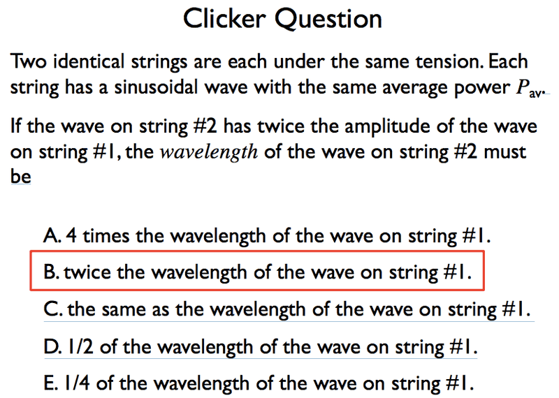

ChloeYip
93
http://i.imgur.com/sWZS9vQ.png
P=½ √μF ω2 A2
How is the equation related to the wavelength?
Your relevant equation has frequency in it. What connects that with wavelength?
Where is frequency in the equation?
the F in the equation isn't meaning force (i.e. tension)?
well, i think w is directly proportional to frequency from this web, leading the answer b, right?
frankly, i just copy the equation from my textbook "university physics" of Young & Freedman
every symbol means the same to the website other than F is missing in the website.
does it mean anything for the difference?
thanks
thanks
Since wave velocity is √(tension/linear density), the two equations are the same.
ω is the angular frequency, i.e. in radians/time, rather than in oscillations/time.
what i mean is w = 2 pi f
thanks for telling me this new thing :)
