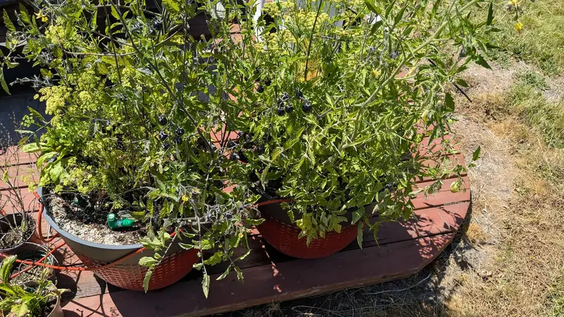

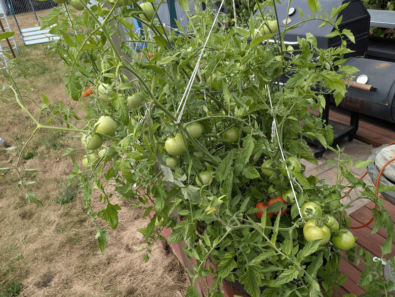

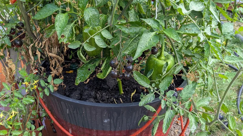

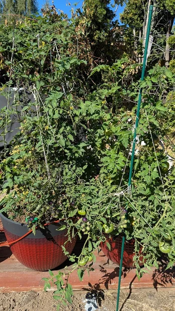

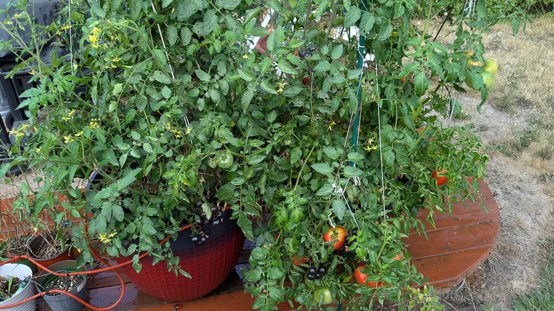

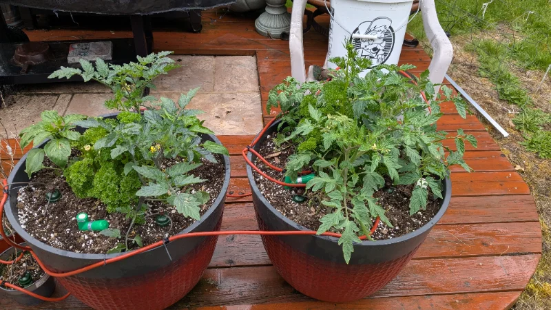

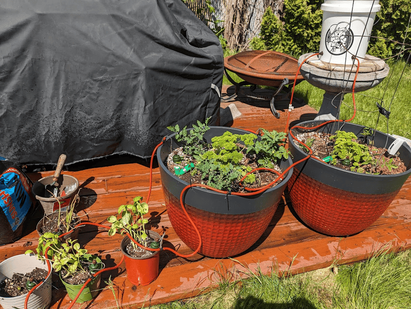

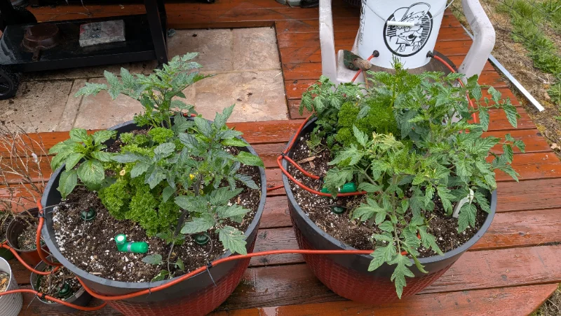

Watering systems. Last year I grew tomatoes in a few big pots. It worked out perfectly with a manually refilled watering system in a 5 Gal bucket
Garden deck with several potted plants on red-stained boards, joined by orange drip-irrigation tubing running from a white bucket on a pedestal, with a black cover over a grill at left.
https://www.blumat.com/en

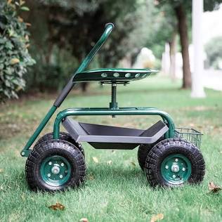

Green rolling garden seat with a rounded seat, a basket on one side, a telescoping handle and four wheels, sitting on grass in front of two large pots of young plants on a wooden deck.

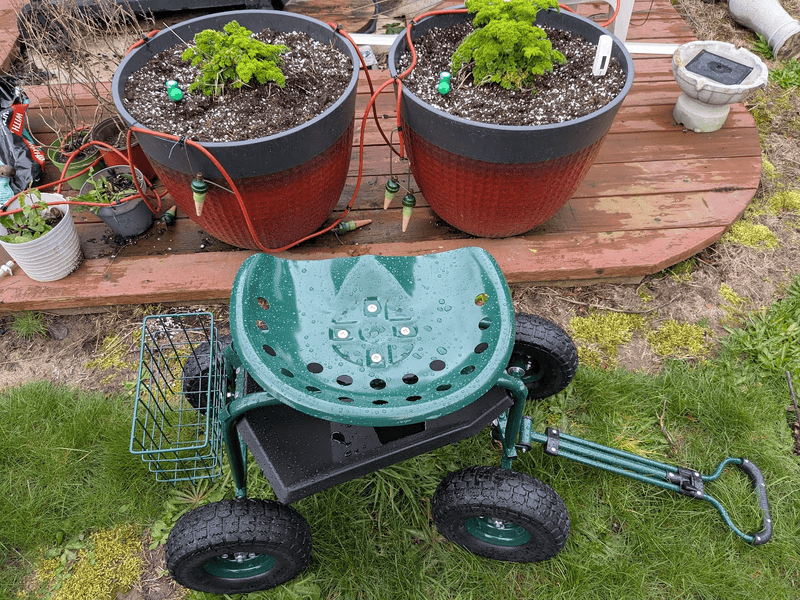

I have my mobile brain seat for the garden. Still too early to plant tomatoes here. Frost warning for this week.

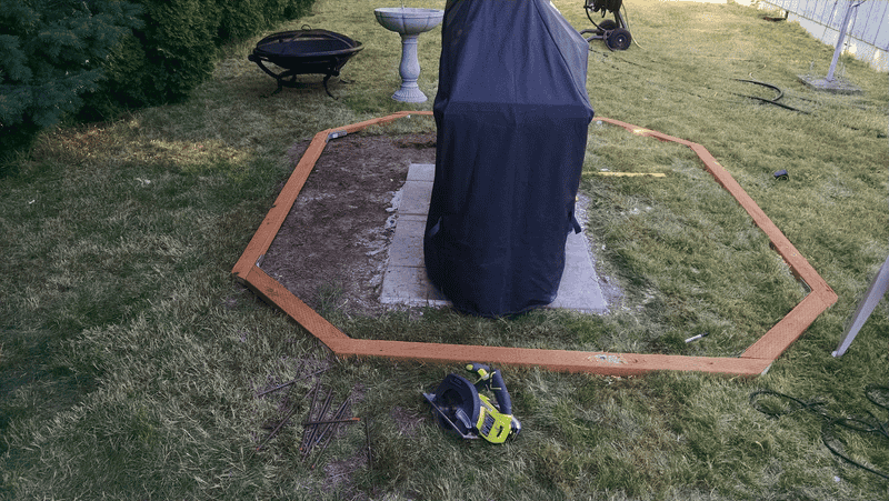

The new stuff is a lot safer but untreated hemlock or cedar is better. The "secret" to slow rotting is to keep moisture moving away from the wood. Membranes, gravel and clean fine soil all tend to wick rotting moisture away from the wood. It won't stop the rot but it will delay it and increase the stability of the structure.
A cooking and planting deck foundation. Using direct ground contact quality PT lumber because all plants will be in pots.
https://www.capitolcitylumber.com/all-treated-lumber-is-ground-contact/
Ground Contact Lumber
Ground-contact lumber is pressure treated with chemicals to withstand the effects of being close to the ground, in contact with the ground, or exposed to continuous moisture.
Ground contact lumber is made for outdoor projects where the wood is exposed to all types of weather or has a high potential for decay. This includes salt water exposure.
Above Ground Lumber
Above-ground-contact lumber is treated to withstand rot and decay even when it physically touches the ground, water, or leaves. Any above-ground lumber is treated to a lower standard of resistance.
It’s often been talked about using “Above Ground Treated” lumber or lumber that is 18” above ground level and will not be exposed to an area that will stay moist due to the treatment being lighter on this wood.

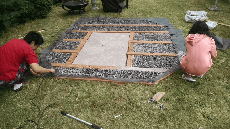

Two people kneel on grass building a timber base: wooden framing laid over a grey membrane on gravel, with a pale concrete slab in the centre.
The drying zone under those surface wood planks. Helps to stop warping and rot.

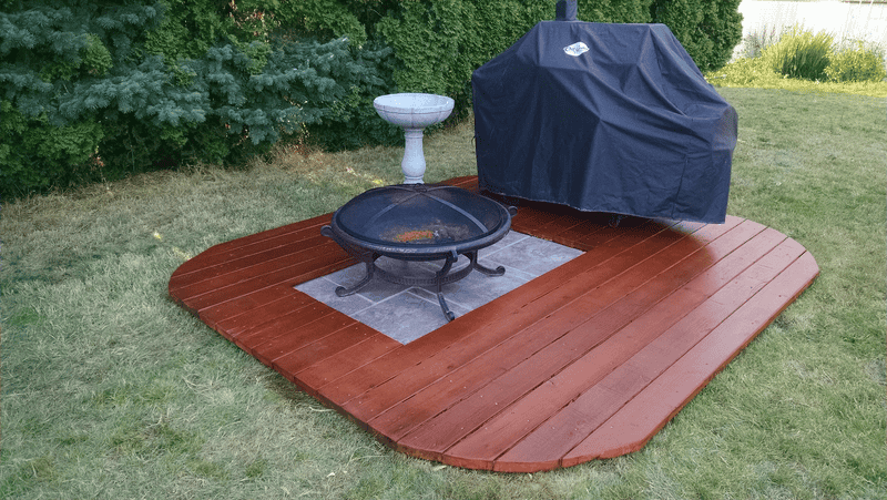

Reddish-brown stained wooden deck in a lawn, with a square grey stone tile inset holding a black metal fire pit, a white pedestal birdbath behind it, and a dark cover over a grill at the back.
Time to re-stain the surface wood.

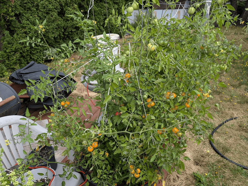

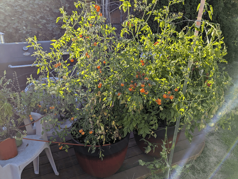

Tomato plants with many small orange cherry tomatoes and some green unripe fruit, growing in large dark terracotta-colored pots on a wooden deck.
Last year's crop.

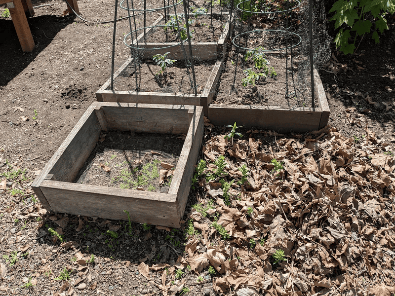

BitD in Northern California we used untreated redwood planks, ubiquitous and inexpensive at that time, placed in trenches in the soil and also to pin down fabric and contain mulch. Redwood lasts for years, longer than red cedar planks IME, though cedar makes superior mulch.
Mother developed an effective strategy against pests particularly snails and slugs. Plant a border of various marigolds and related daisy flowers that look nice while inhibiting certain pests. AFAIK bees are not harmed.

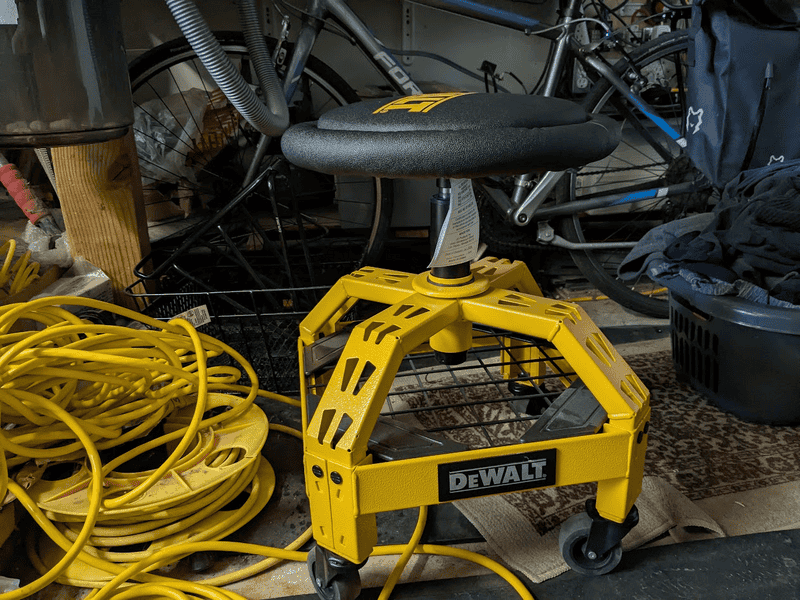

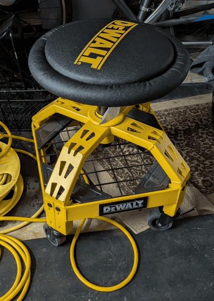

I also have the work shop rolling chair.
Yellow DeWalt rolling shop stool with a black padded seat and casters, sitting on a rug next to a yellow extension cord reel and a bicycle.
Yellow and black DeWalt rolling shop stool with a padded black seat bearing the DeWalt logo, a steel frame and four casters, with yellow extension cords coiled nearby.
Bad knees are not going to stop me from working at home in retirement.

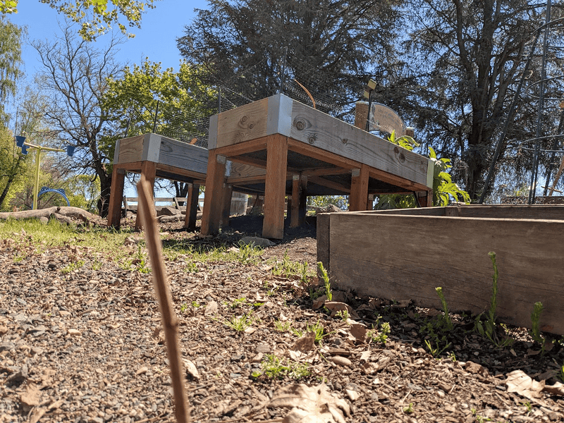

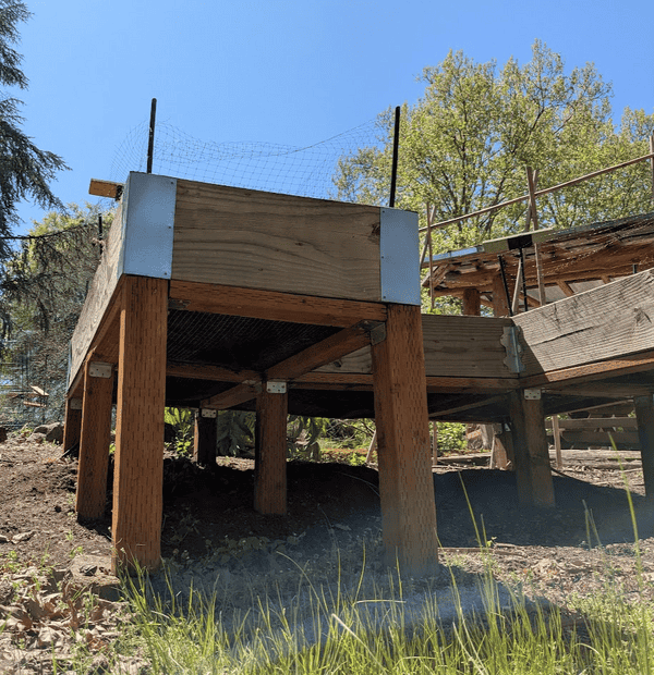

At the park today they were setting up some vegetable planters.
Two raised garden beds on tall wooden legs in a garden, with soil planted with young vegetable seedlings, a wooden pergola and picnic table behind, and smaller low beds on the right.
Raised wooden planter box under construction on wooden posts, with a bare plywood or board frame and metal corner brackets, set on bare soil outdoors with grass and trees behind.
PT supports for what looks like a cedar or hemlock soil box.

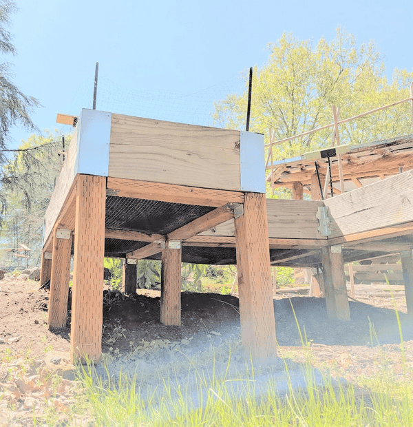

Wooden frame under construction on posts, with a raised box of planks on top and wire mesh visible underneath, set on bare soil in a grassy outdoor area.
Adjustment to see under a little better.
Low-angle photo of two raised wooden planter boxes on wooden legs in a park, with gravel and wood chips underfoot and trees behind.

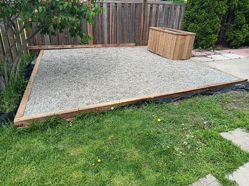

The project scope is creeping.
I'm going to level the area (about 15'x15') with gravel or stones. I'll hold the gravel/stones into a big square with railway ties spiked into the ground.
The last tme I tried to make a walk area with stones around my aboveground pool, they all got stomped into the mud and it made a mess. So I'm a little trepidatious about that.
And then I've got to figure out a watering system. I'm not sure soaker hoses will work in raised beds unless the entire watering system is at the same height. Soaker hoses don't do well with changes in height.

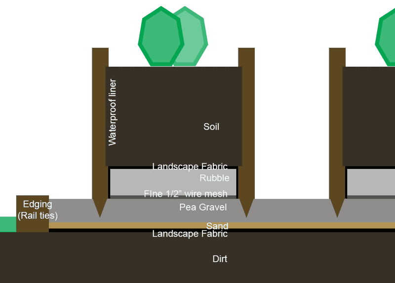

OK. I have no idea how to prep the ground.
This is my guess.
Cross-section diagram of raised garden beds: waterproof liner, soil, landscape fabric, rubble, fine wire mesh, pea gravel, sand, landscape fabric and dirt, with rail-tie edging at left.
Garden Plot:
  • The area has had landscaping fabric laid down to kill what's been growing there to-date. I'll leave it in place.
  • I'll throw a few inches of pea gravel down, over a layer of sand to stabilize it.
  • The whole area - about 15'x15' - is surrounded by edging (prolly ersatz railway ties) to keep the gravel in.
Planters:
  • The planters sit on the pea gravel.
  • The (open) bottom of the planters will be covered in fine 1/2" mesh to prevent critters burrowing up into the planters.
  • The inside walls of the planters are lined with waterproof liner, so water isn't lost through the wood planter walls.
  • The bottom 6" of the planters will be filled with rubble / clean fill. (We only need 18" of soil for gardening, but we want the planters to come up to 24".)
  • On top of the fill, a layer of landscaping fabric, to prevent good soil from getting lost in the rubble/fill below.
Again, this is a guess. Is this over-engineered? Anything I don't need?
The only thing I want to avoid is having to do any digging/leveling of the area as part of the prep. I just hate digging out a giant area (225sq ft.).

A step up from waterproof liners, which can get damaged over the years, would be pressure-treated wood to resist decay when used outdoors.
The whole thing is made out of PT wood.
The liner is to stop precious moisture from leaking out.

Honestly, I think it is. But it'll work just fine.
Depending on the length of the box and the height of soil inside you may need to tie the opposing sides together somehow.

Raised beds cost too much money. Lumber, screws, nails, potting soil, will cost very near $100 per bed. Potting soil is not real soil it is composed plants and has almost no food value of live plants. If your yard is rock you may have no other choice but to have beds. The taller beds are the dryer the soil is. Plants do not like uneven soil moisture. You need drip line irrigation or manually water plants every 2 hours all day depending how hot and dry your geographical location is. I took, biology, horticulture, physics, electronic, FFA, chemistry, engineering, and more it college, that was educational but it did not prepare me for growing a home garden. Your beds will work fine made with 5/4" PT lumber setting on your yard. If you don't like bending over put 3 ft tall legs on the beds. Beds need to be hand weeded. Tomatoes grow best on 6 ft tall stakes. 10 bird houses are very helpful to kept bugs gone. Learn about fertilizer, NPK. N is nitrogen, P is phosphors, K is potassium. N is very quick to be gone in soil in 3 months if your weather is 100°f. P will build up and become toxic to plants if your not careful. K builds up in the soil also. Lots of rain washes high P away to a safe level in about 5 years. Rain washes away K in about 10 yrs. Certain plants need calcium to prevent BER= Blossom End Rot in, tomatoes, peppers, squash, melons, cucumbers, peppers. Corn only needs nitrogen and does not pollenate well with less that 300 plants. Farm supply sells fertilizer in 50 lb. bags $20 each. So called organic plant food in small 5 lb. bags is $20 each. Get a soil test every year and learn how to read and understand a soil test many of the place that do soil test has no clue what the numbers mean. Learn the correct date to plant each plant. Most vegetables need to be planted after your last frost, beans & corn soil temperature needs to be warmer than 65°f. Plant potatoes & onions 6 weeks before last frost. I tried beds once, waste of my time and money and too much work. I do low maintenance garden I seldom do 15 minutes work per week in my 30ft x 60ft garden. About 1st week of June I will have 600 lbs. of potatoes to dig up. Tomatoes will be ready to pick about 1st week of July to Nov. 350 onions & 100 garlic will be ready to harvest about June 20. 5 kinds of peppers should be ready to pick July 10 to Nov. 450 ears of corn harvest about Aug 1st. 4 kinds of melons harvest from July to Nov. Beans July 15 to Sept.
Vegetable garden with rows of corn on the left, a row of green bean plants climbing wire cages in the centre, and a row of green onions on the right, with mulched soil between rows.

12x12 Bed finally laid. One planter in-place.
That's $450 for 3 yards of stone. (OK, it's $200 in stone plus about a 100% markup for delivering it in cubic yard bags, rather than dumping it all over my driveway.)
First planter (4'x2'x2') cost about $110, each subsequent is getting much cheaper and faster.
Each planter will require about 12ft3 of fill - 1/3 rubble in bottom and 2/3 soil on top.
Outdoor patio base of gravel framed by timber boards on lawn, with a wooden planter box at the back against a fence.
So,
Bed: wood+gravel=$500.
Planters: 7x$100=$700.
Soil: 2yds=2x$180=$350.
Total: $1550.
How long do you think it will take my wife to produce $1550 in vegetables to make this a profitable initiative? o0)
