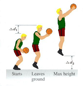

A 93.7 kg basketball player can leap straight up in the air to a height of 83.7 cm, as shown below. The player bends his legs until the upper part of his body is dropped by 58.1 cm, then he begins his jump. With what speed must the player leave the ground to reach a height of 83.7 cm?
I'm really stumped on how to do this question. I tried calculating the velocity he has when he reaches the ground, but that isn't right.
I don't really know what to do with the distance he drops his body by either.
A little help please?

What does the picture "shown below" show?
did you change everything into SI units?
Here is the picture. I hope this works!
And yes, I changed it to SI units. Thanks for the suggestion anyways!

The distance is given as d = 83.7 cm = 0.837 m.
meudiolava said:
I think I have to do something with the fact that he's bent over a bit, but I have no idea what. I also don't understand why my method isn't working.
Any suggestions would be much appreciated.
Your method is correct. The fact that he is bent over appears to be irrelevant to this part of the question.
