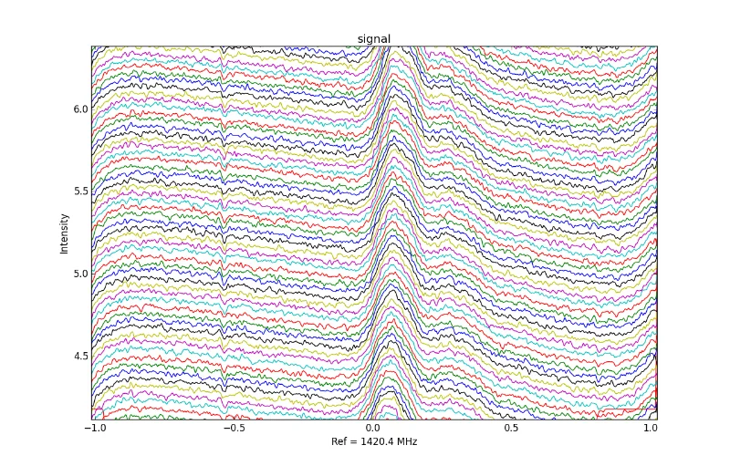

  • #61
We used no dish and no low noise amplifier; just a bucket as shown in the picture.
The project description can be found on
http://parac.eu/projectmk9.htm

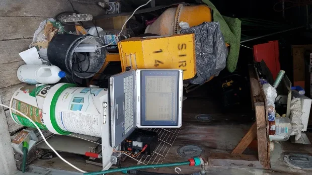

  • #62
Was the antenna followed by three satellite TV amplifiers in series ?
What was the RTL dongle plugged into, and controlled by ?
Where was your mobile phone at the time ?

So, the plot shown in post #55 shows a peak. How many dB above the background is it? I ask because RTL dongles have pretty high noise figures. In this link
https://www.idc-online.com/technica...se_Figure_Measurements_of_RTL_SDR_Dongles.pdf
The author measures a noise figure of 17dB at 700 MHz for a garden variety SDR. This means the radios noise temperature is 17dB hotter than room temperature. That’s pretty hot. Is the peak you’re seeing consistent with the noise temperature of the hydrogen you’re looking at?
Did some digging. This paper
https://web.mit.edu/lululiu/Public/8.14/21cm/21cm.pdf
Is an interesting read and quite basic. If I understand Figure 8, the gas you’re observing is only 45 or 50 K which is colder than 300K room temperature by a good amount. Makes me question the results in #55.

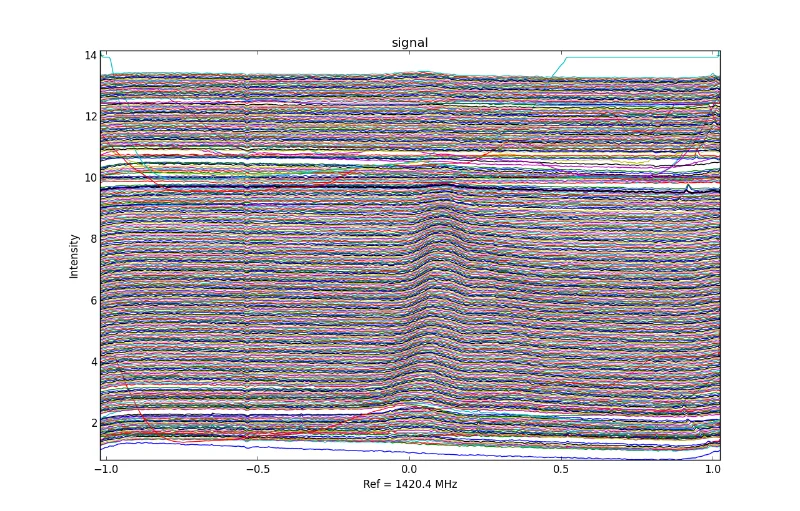

  • #64
That estimate for galactic source temperature is about right. When the Sun is quiet, it has lower flux than the galactic centre.
The observations from the SDR only cover 13 hours. If it was an astronomical emission, galactic or solar, then we would expect to observe a daily cycle with sidereal or solar periodicity. That is not evident in the short record presented. Even with a 13-hour observation of astronomical signals, I would expect to see some artefact of the antenna pattern, swept across the source by the rotating Earth. A two element interferometer, arranged E-W, with only a couple of hours of observation, would be conclusive. Maybe they use one broad-beam bucket, rather than two, to avoid disappointment.
Until we see a longer record, something that shows a repeating daily periodicity over at least two days, we have to assume the signal being presented is local RF interference, thermal noise in the TV amplifier chain, or in the front-end of the SDR.
At this stage, all the evidence says the project is not radio astronomy.

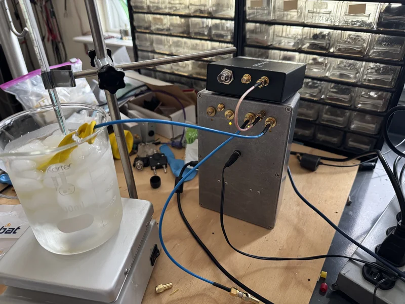

  • #74
Before I get out a hacksaws and take multiple trips to the hardware store building an antenna, I thought I would first see if my Sdrplay RSPdx is even capable of detecting the small temperature changes needed to make observations of the 21cm hydrogen line. The radio has a LNA built in making life simple. I'm using a coaxial switch box to alternate between a 50 ohm load at room temperature and one I've placed in ice water. The temperature difference, ##\Delta T = 22.2## degrees kelvin. The change in power output expected is,
##\Delta P = 4 k_B \Delta T R##
where ##R=50## ohms. The x axis is in MHz while the y axis is mW. The blue curve is the difference in the measured power in mW with both terminators at 72 degrees F. The displacement from 0 is due to small differences in the cables, connectors, switch positions etc. Ultimately I hope to calibrate these out. The yellow curve is the same with one terminator is immersed in ice water. A ballon is used to keep it dry.
This is still very much a work in progress. It's unclear I have all my factors of 2 in place. The observed change seems smaller than expected. Anyway, I'm convinced this test shows enough life that astronomical observations using this setup are in fact possible.
The power spectra shown are 2048 bins wide. Data is collected 1000 times for each switch position and 100 such cycles were taken and averaged. Each curve is about 6 min of data collecting. Between each switch change a dwell of 10 spectra are taken and discarded to ensure switching noise has died out between data sets. The IQ sampling rate is 2MHz.

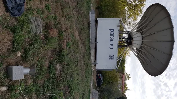

  • #78
The very first time I could detect hydrogen with an antenna I was amazed and overjoyed.
That is why I offer,whoever want to do likewise, my support.
Dont build complicated systems; just start simple and have success.
I have repeated the project
I am now in Portugal and now the bucket is replaced by a tube on the ground and an ali amplifier.
The tube was positioned first to the polar star, so the milky way is circumpolar and always visible.
The beamwidth of the tube is 57*lambda/tube diameter, so about 80 degrees.
Next the tube was placed to the zenith.
I have put a flare onto it, and again according to Huygens principle with 320mm diam outer rimm, it should become 40 degrees.
This narrower beam will give more details of the milky way arms.
Directing the tube with flare more south will give a transit twice through the milky way plane, giving separate bumps on a different frequency.
The signal is strong enough; if you wat more detail, then make the beam more narrow, for instance by adding a flare or dish.
I want to add that the s/n ratio of the sdr is not so important; the first amplifier is.
See the excellent explanation by Marcus in this thread.
Further it is important that fast sample and FFT software is chosen; I use free CFRAD2.exe
This software will sample and add 100000 spectra in 5 minutes.
Also use a multicore PC, because one core will be fully occupied.
see www.parac.eu
Concerning masers; see for instance the project 'masers with a 1m dish'
http://parac.eu/projectem01.htm
